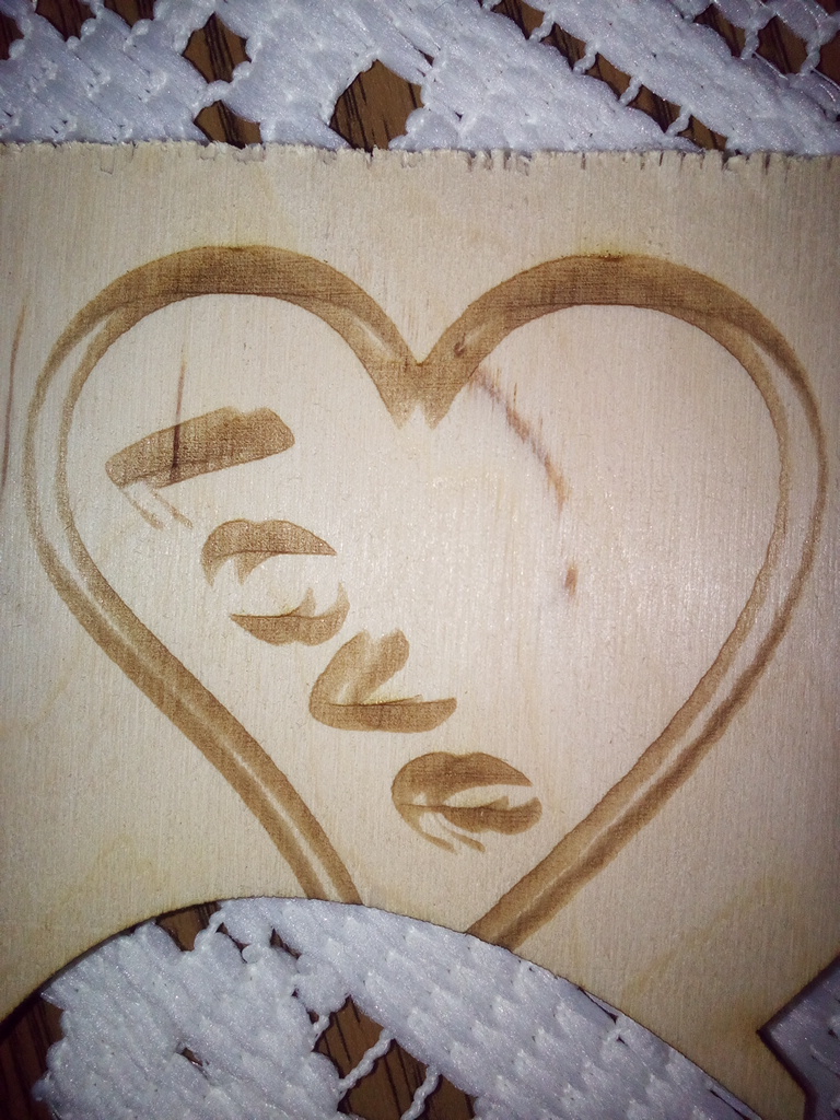

I replaced the laser tube and the power supply to a 60-watt.
Since then a laser engraving and quite poor.
What could be the problem?
as if it would receive two signals.
thanks for the help.
That is a bad alignment problem…align mirrors and head…that will solve the problem.
I agree I had the same problem, its almost like a reflection inside. But when I aligned correctly made all the difference.
