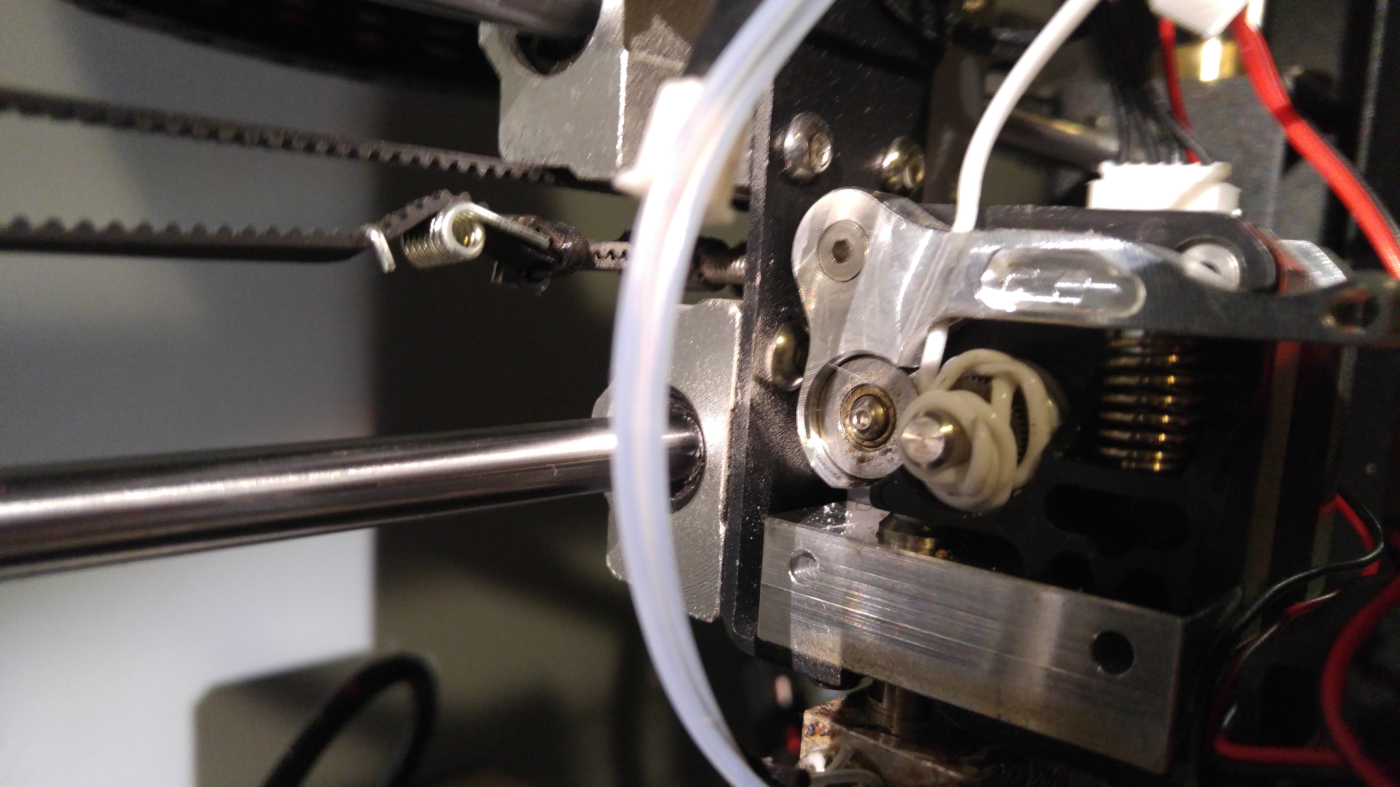

Hoooo boy. Bit of a jam in my Wanhao Duplicator!
I love the belt tensioner!
@Scott_Calkins ​ This kind of springbased belt tensioner is known to introduce artifacts…
https://www.thingiverse.com/thing:981670 replace the spring tensioner with this.
Also if you lift the barrel of the hot end higher it will have less chance of twisting like that
Took a bit, but got the jam cleared and everything recalibrated, all in all about an hours work. That tensioner was out of box but I like that other one! Know what I’m doing this weekend!
@Michael_Scholtz ​ Thanks! This was the first time I ever had this happen. Been fighting the past week with some cheap @$$ filament a bud got me to print a Dredd law giver, I finally gave up and switched to my good stuff after clearing the jam, he owes me… Been printing beautifully all night since switching filaments. But when I change filament I’ll lift it a smidge.

@Fabrocat_TM Where have you been hiding my whole life? Or at least the past 4 months since I’ve been printing? I upgraded the plastic lever with an aluminum one and the gripper with an iron one with smaller teeth and that took care of about 90% of my issues. This may handle the other 10%…
Just a little bit of misguided filament. Lol. Kinda looks burnt too.
Actually yeah it was! My primary fan went out, so the filament melted and that’s what caused it. Replacing this afternoon
@Joshua_Donovan - Bummer. Did the fan bearings fail? I have heard some screeching from mine now and then. I need to get some replacement fans and just replace them before they die.
yeah, just been running it too much I guess. Replacement was only a few bucks. Getting everything dialed back in today hopefully.
