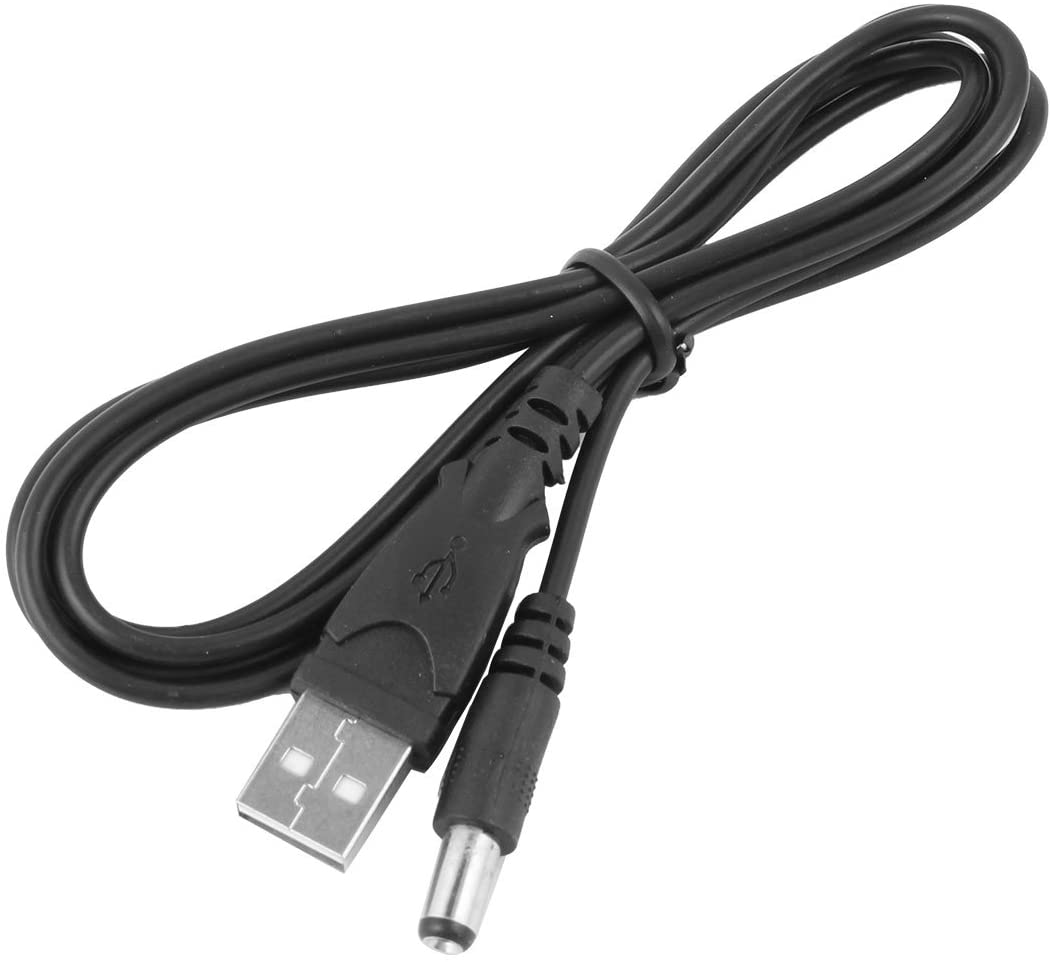

As for connectors I have been using USB to barrel jack connectors. Like this…
for everything, I put the mating plug on all my projects anyway and this opens a whole ecosystem of other parts, like switches, extension cables, and splitters that you can tap into. Makes it easy but I guess at these higher amperage ratings I am going to have to watch my wire gauges.

Pretty sweet @Eric_Daine_ednspace ​, didn’t know those existed, but I will definitely look into using those barrel connectors. Looks way less ghetto than chopping apart a usb cord.
