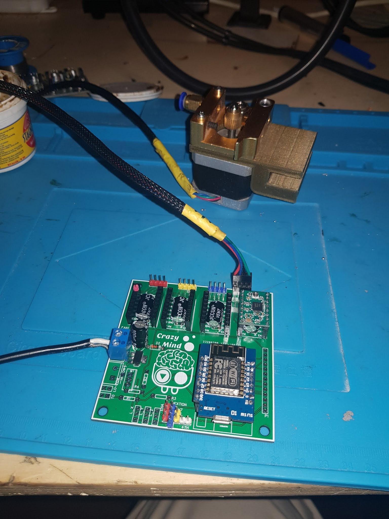

Hope soon we(me and Darkberg Aryavis ) can release a new ultra cheap board
Hope soon we(me and @Darkberg_Aryavis ) can release a new ultra cheap board (for cnc printing foamcutter laser) working with D1 mini (ESP) that are a fork of kyaracontroller/repiter dedicated and cleaned for wemos D1 boards in pic we s can tested on old SUMPOD or with external driver Tb6600 l by @Maxim_Melcher PowerPony on plasma or foamcutter cutter.
Happy view.
Kit

https://youtu.be/nG_9Fqu-0Oo currently via usb , wifi need we need a check on code/power because some time work and sometime esp going in loop of crash , via usb no issue. original code not really write fine currently want make stable board and after start coding. anyway just in usb like i like result.
