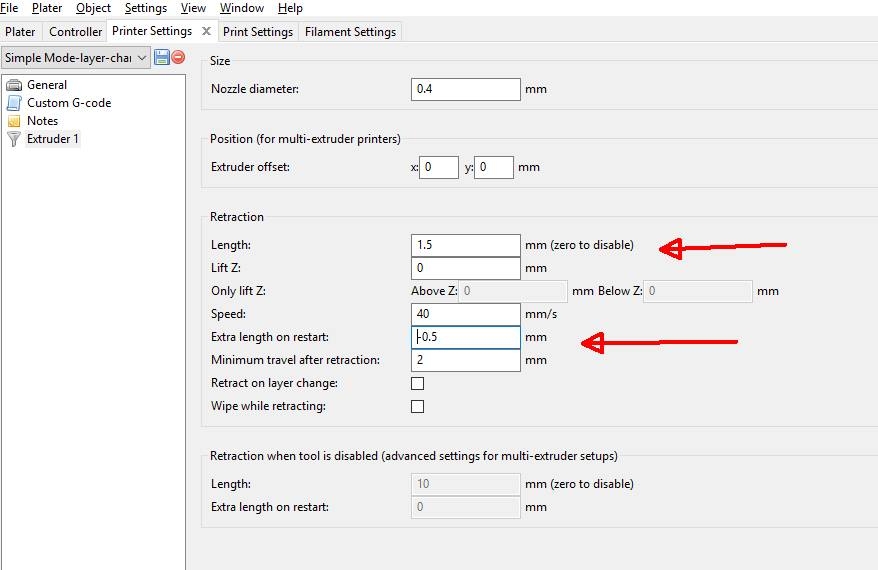

Working to get rid of zits on some tall round prints in Petg. Tries a lot of slic3r settings in 1.3.0-dev to no avail. Tried Cura 2.6.1 still there.
They appear to show up at end of layer.
Only print I have gotren with no zits was in Slic3r 0.9.9 and it took 4 hours. Tries to duplicate those speeds etc to Slic3r 1.3.0 still had zits. Played with retraction, seeing no improvements.
Hatchbox black petg 240 nozzle, 235 nozzle, etc.

I went back into the gcode and although they may be doing two different infills between that much version, there was nearly 3mm more filament in the zit fested slice vs the smooth one.
When back to the printer, will make a .1 change to extruder to extrude less (.9) in my case and see what that looks like for zits.
