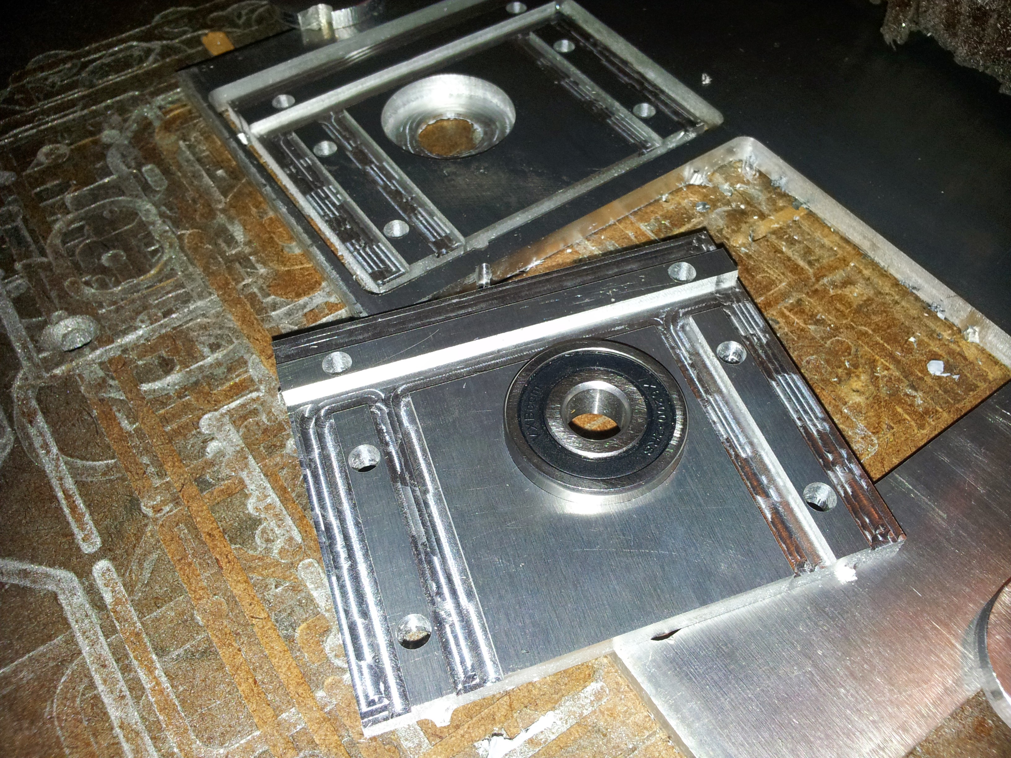

Hot off the CNC. Another pair tomorrow morning and the Y-axis can be upgraded to provide some more stiffness to the top of the machine.

Did you build the cnc yourself?
Huh. I assume the grooves align with the channel in the 2020? If so, that is going to make one very rigid frame. Double awesome.

Started out as a shapeoko 2. Upgraded a couple of things for added stiffness. Abandoned makerslide completely. Now it’s a hybrid shapeoko/openbuilds/misumi machine. 600x600 footprint. Sits on my desk.

Yes. Those grooves are 1.65mm deep and allow the remaining ribs to slip into the 6mm wide channel of the 2020. The frame is very stiff, and will only get stiffer with the rods and these new end plates.
What did you change to be able to mill aluminium? I have enough bits left over from my build to make two more smaller machines - I am already making a Routy to sell, I could really use something that can cut metal.

@Mike_Thornbury I moved to HFS5-4040-600 on X and Y and mounted openrail to it. On Z I moved to HFS5-2060 with openrail and cut a new mount from 1/2" aluminum. NEMA23’s for everything. Still using GT2-6mm belts on X and Y. 3/8-12 Leadscrew on Z. That’s really it.
Your OX should cut aluminum no problem. With that spindle your real limitation is going to be gantry flex. But you should be able to cut AL with zero issues. Just go slow (at least initially) and slow down the spindle. A little lubrication goes a long way too. WD-40 or some A9. Lately I’ve been dry milling though.

A friend of mine built a Burch plywood CNC… works great on wood… don’t think it would do aluminium tough. Could you post some pictures of your model ? this is blowing my mind ! LOL

All my OX cuts is aluminum. I’m running on 6mm wide GT2 belts. I do have to run a little slower than a rack and pinion would cut, I imagine. Run at 180mm/m, 4mm carbide single flute upcut, .4mm per pass, 12k RPM. Pushed it to 250mm/m but would walk occasionally. I’ve been running dry too for a while. Tool doesn’t last as long but the clean up is much easier.
Nice use of holding tabs. Are they triangle with a lead in?

@Brandon_Satterfield these plates are a 2 hour job. Roughing @ 7.5ipm with 0.03in DOC. Finish passes @ 10ipm with 0.02" removed @ full depth. 1/8" 2 flute upcut. All this with the makita set at 3.5/5. I could go faster and deeper, but the whine of the spindle hurts my head, even with hearing protection. Yup, triangle holding tabs. A spiral ramp lead-in in the profiles and a tangential one for the climb mill finish pass. Everything was done in inventor fusion and cambam.

Your OX looks very rigid. Do you have mid-span supports on the Y-Axis? Is you speed limitation due to the spindle cutting power or machine flex?
