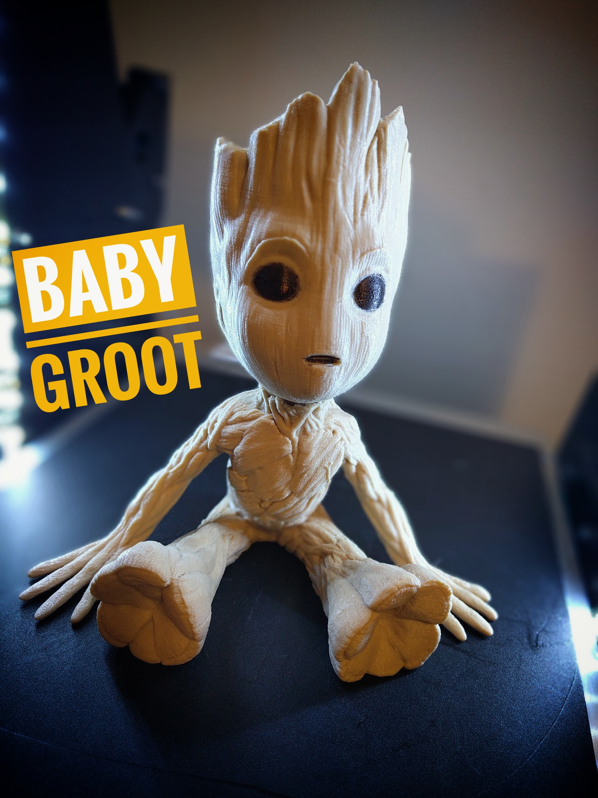

Hictop Prusa i3. 30mm/s @ 0.12 layers, 3 perimeters, 5 top layers, 10% infill at 100% size.
Used the Robo3D Wood PLA @ 210°
