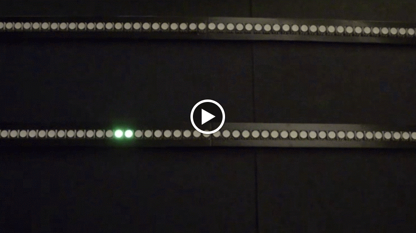

Houston, we have a problem with the 2.1 branch.
Houston, we have a problem with the 2.1 branch. It doesn’t know how to count, but only on the blue channel. The 2.0 branch does not exhibit this issue. And in trying to explain it I realize I’m too dang tired … I didn’t understand my own writing. So instead here’s a video. Basically look at the blue chase as it reaches the end of the 48 pixel strip. I purposely slowed it down when it hit pixel > 42 so it’s visible. It only happens on the blue channel and only on 2.1 …

By the way, when I was testing half-strips, so only 24 pixels, it worked fine. It wasn’t till I put two together for the full 48 pixel length that this happened.
Yeah - I used to have code that wold send one pixels worth of data extra and turned that off. It looks like I need one last clock strobe to get the data locked in. I’ll toss that in tomorrow.
Why would it only do it on one channel and not all three though? Wouldn’t the code to send the data be the same across all of them, just the channel value is changing …
Probably because that last led is getting 8 bits of red data (8th bit registered, latched in), 8 bits of green data (8th bit registered, latched in), but only 7 bits of blue data (because the 8th bit hasn’t reigstered/latched - hence the “strobe the clock line one more time on the way out”.

Nope, still does the same thing. I grabbed the latest 2.1. I have dithering disabled, using the SPI port, and it’s doing the same thing, only on the blue channel.
Ah! I think I found it - the LPD8806 has a set of zeros that get sent out to latch data - the current code does one 0 per lpd8806 rgb pixel, but it looks like it needs to be one 0 per byte of data that was sent out. It also looks like the lpd8806 will latch a byte’s worth of data after passing through a byte’s worth of data. The reason why that last blue doesn’t come up is because it never latches.
I just pushed code that sends a number of 0’s based on the number of bytes being written, vs. the number of pixels - let me know if that helps (I’m visiting family, and have access to code to tweak, but not leds to test).

Ok, the last push fixed it.
