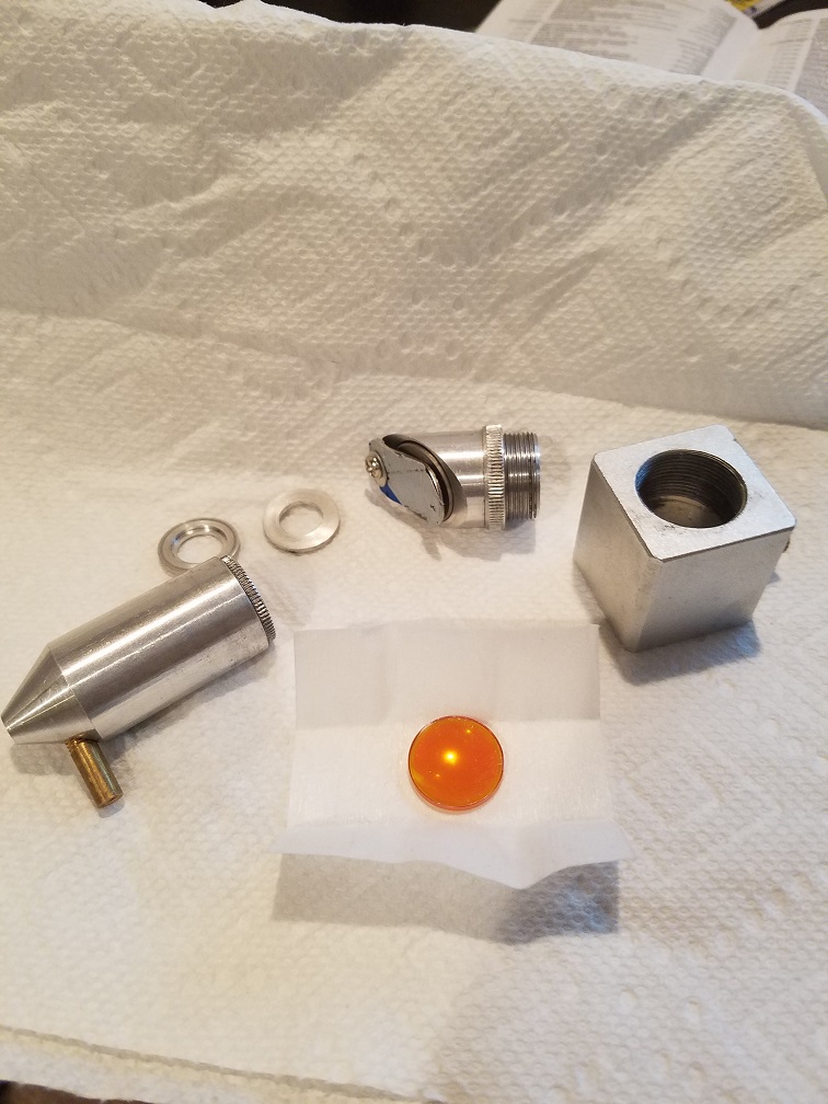

How are people installing their saite_cutter 18mm ZnSe heads. I’m having trouble getting the mirror to sit in the laser head. The provided washers look like they are for a smaller lens. I found some files to cut a mounting bracket, but a little lost on the lens placement, think I got the mirror down. I saw someone using a rubber o-ring to secure it but wasn’t really sure. Thanks all!
Think I just figured it out, didn’t realize that laser head has a screw on the top, looks like it mounts in between gonna give it a shot

The mirror goes in the recess under the spring clip, then the lens goes under the knurled ring in the nozzle. You’ll have to leave off the threaded ring (on the mirror mount), and put a few felt shims or a thin o-ring between the square body and the factory plate, then tighten it up by screwing down the mirror holder. (The shims provide compressibility so that you can adjust it) You may need shims on top of the plate to get the beam lined up in the center of the entry hole - the threaded ring is too thick. (adjustment required so that the beam goes out the nozzle cleanly) - it’s all a bit of an PIA, but well worth it…
Got it mostly assembled now thanks, couldn’t I just take a drill press to the orignal bracket and drill it out to 20mm?
That’s a requirement, You DO have to open the hole up. I forgot the mention that, sorry.
With the lock ring, it’s the height that is the problem. If you leave the ring on, it sets the mirror mount too high (above the beam), without it, it sets a smidge low (about .020). It’s on my list to make some ‘adjustable’ Plates for people with that head. You COULD shorten the 3 standoffs a bit and that would do it too. They all have slight dimensional differences, tolerances on the parts are pretty loooose…
