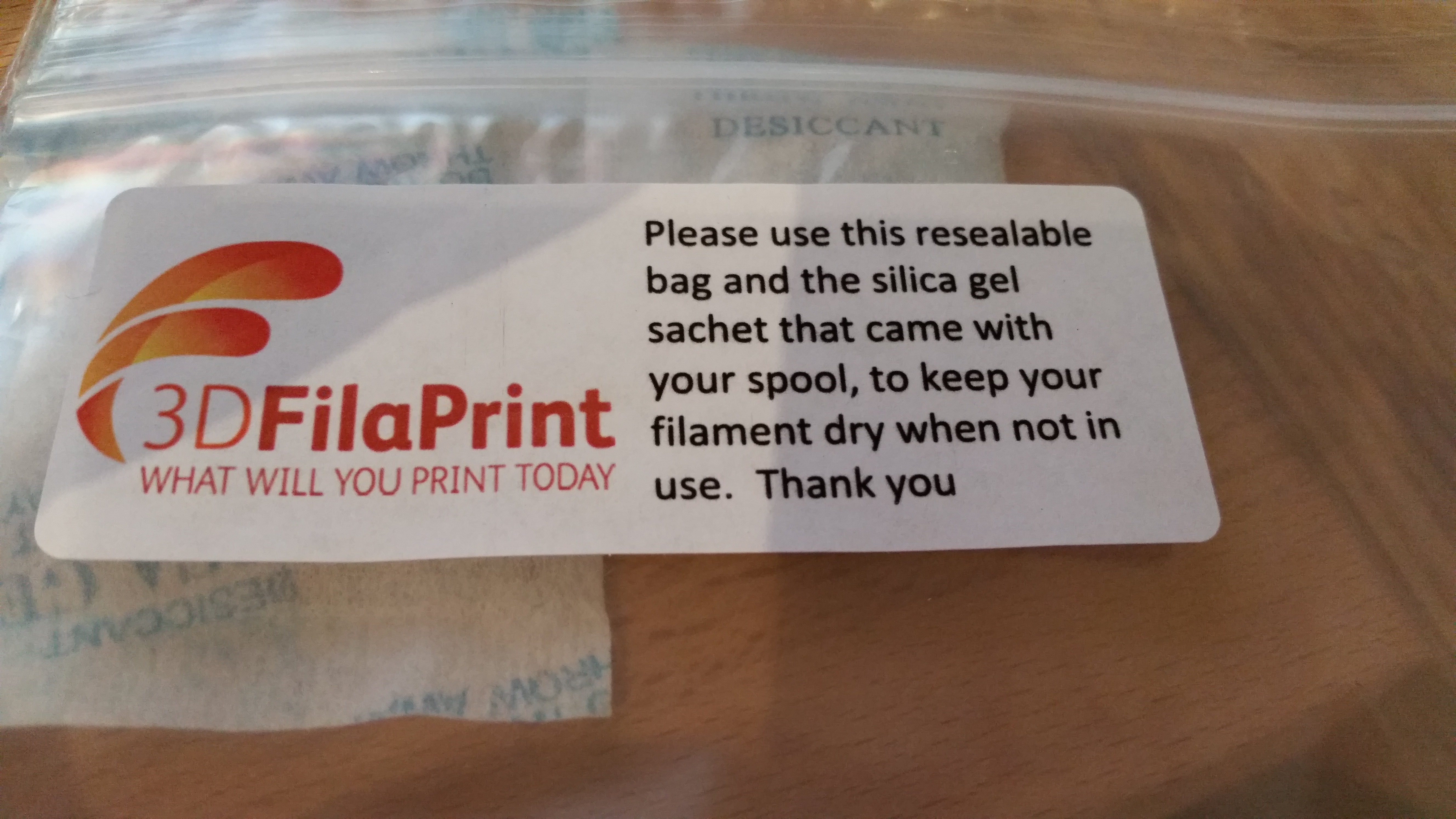

I’ve noticed that PLA gets extremely brittle when saturated (I had it break overnight and thought someone in the house was messing with me until I tried to reload it). If dried in the oven, the original properties return. I like the idea of a container around the spool. For now I put all my filament, sans the one of the printer, in bags with rechargeable desicat. Then I try to swap filaments every few days.
@Mark_MARKSE_Emery It was between 60 to 90 degrees, for about two hours. I had nice, PLA printed spool then - but it got soft and deformated. After baking I put my plastic in container with silica gel, even cat silica gel shall do (although I would prefer this nice one with indicator).

Pla and abs do tend to “expire” if not taken care of properly. I have a cube and the filament almost always snaps now because the last person to use it back in May failed to ziplock any of the filaments. The other problem could very well be humidity and room temperature. I always run my prints in the warmest spot in the house especially during winter to insure that I get the best results.
