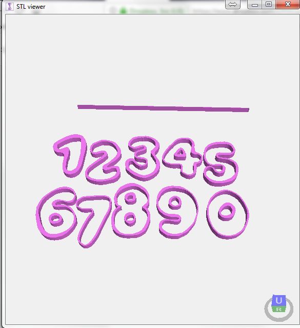

How can I fill the space inside an object as in the example?
https://www.dropbox.com/s/f3tluga4i173xtw/S.stl?dl=0

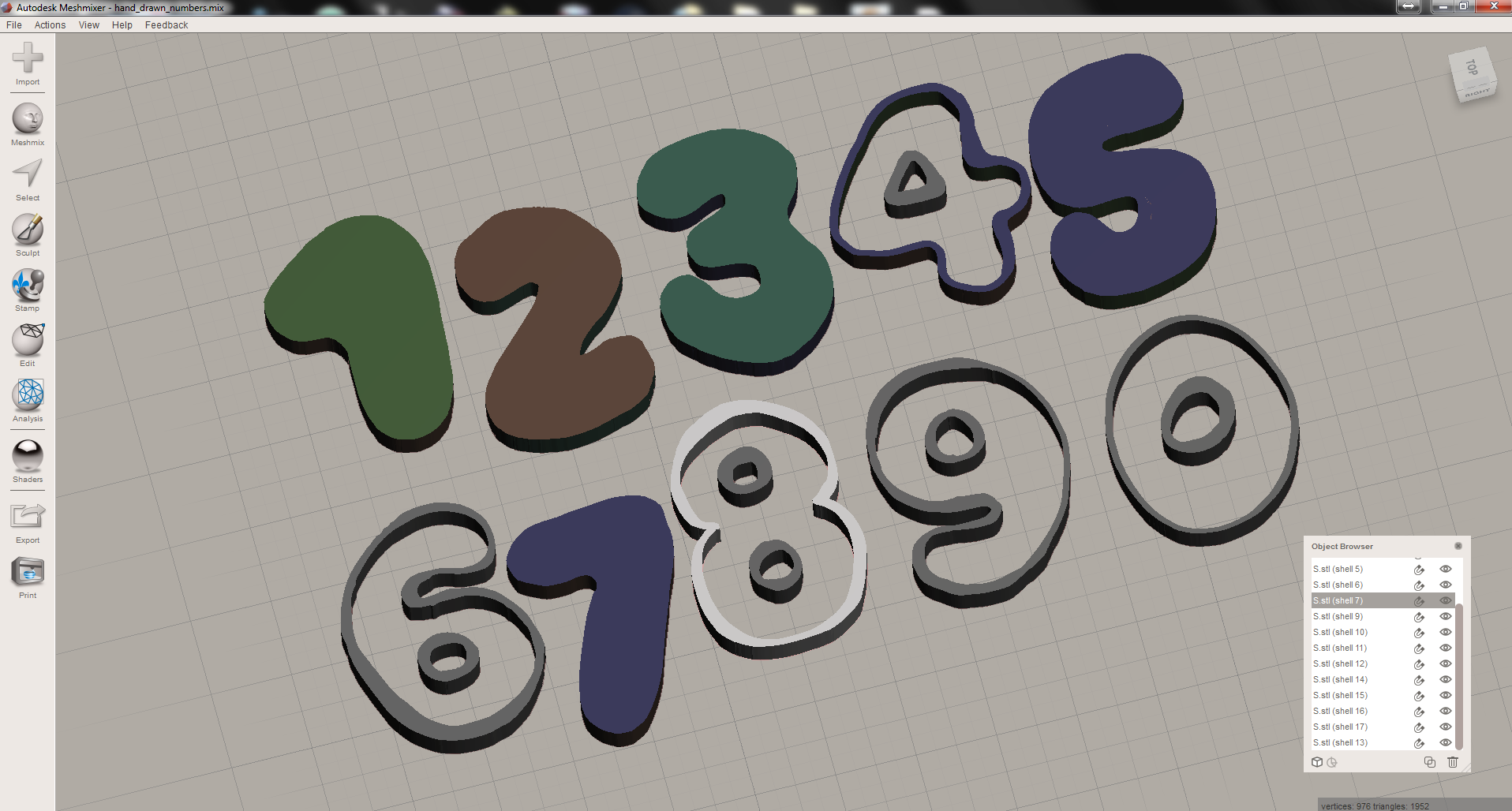

I’ve been able to use Meshmixer to clear away the inside walls of the single feature numbers, then use Analysis/Inspector to repair/fill in the top and bottom faces. The other numbers, 4, 6, 8, 9, 0 haven’t worked in the same manner, due to my lack of familiarity with some of the nuances of Meshmixer.
@Roni_Segoly is this what you are wanting to do? Used a program called trueSpace (similar to Blender) to import your STL, remove all the triangulation, and fill all the holes with faces. Deleted inside faces and then converted the very inside ones back to holes. Took about 10 min. I can send you the STL of the collection if you would like.
