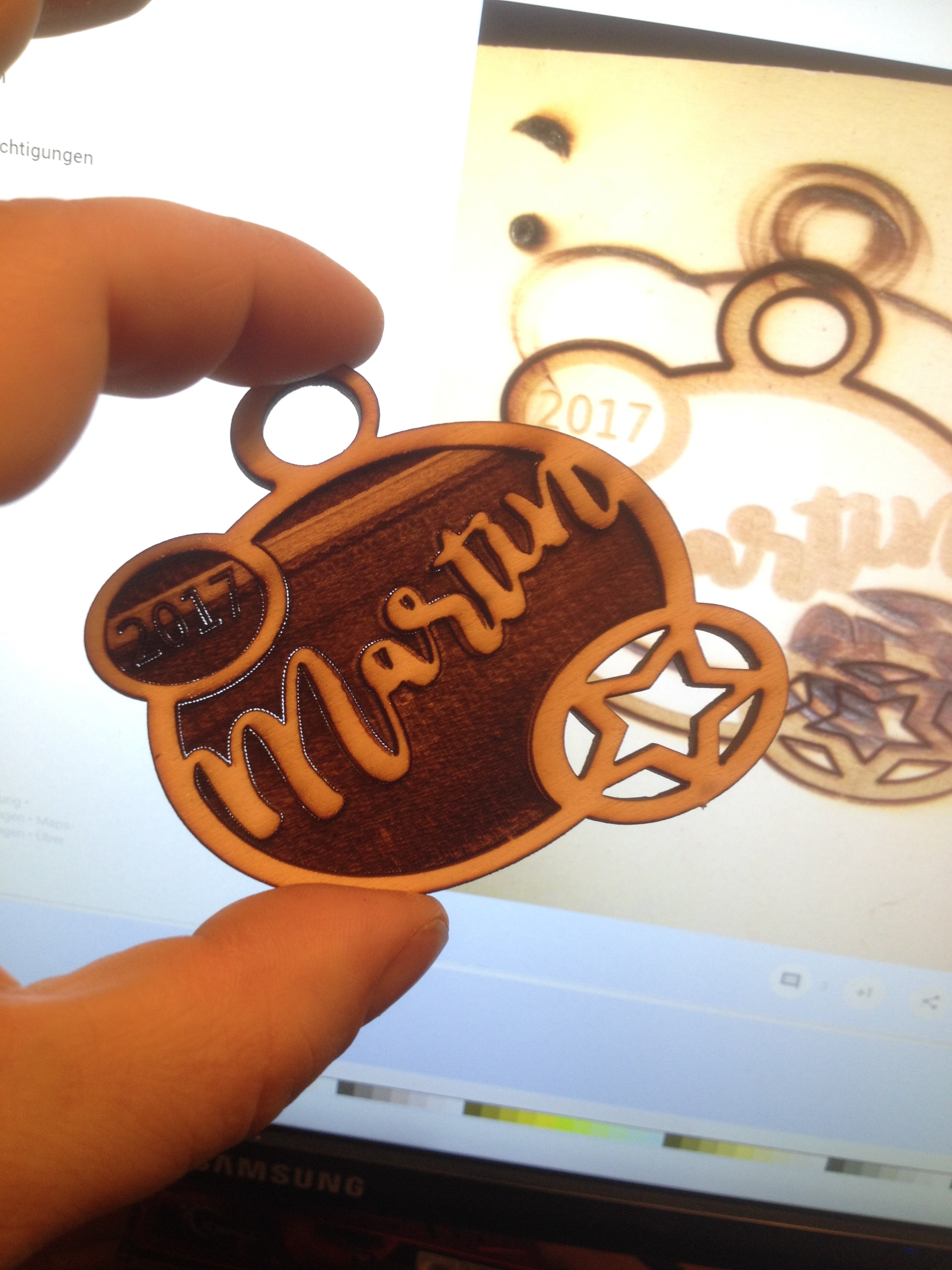

How can I fix, what is happening here?
Mirror alignment?
I think the laser beam is reflecting on the side of the nozzle output. Try to adjust the last mirror to bring the beam to the center of the output.
YES!! @cprezzi , you fixed it, thanks for this christmas present
Very welcome
