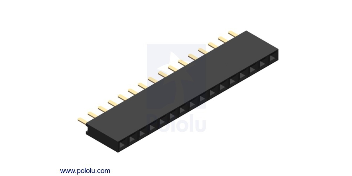

I am soldering headers directly on the boards
and crimp my own wires. All part you need are on this page. Make sure you get yourself a good crimp tool. Pololu - Male Crimp Pins for 0.1" Housings 100-Pack
For Power and Ground distribution, Caps etc. stripboards are quite handy.
