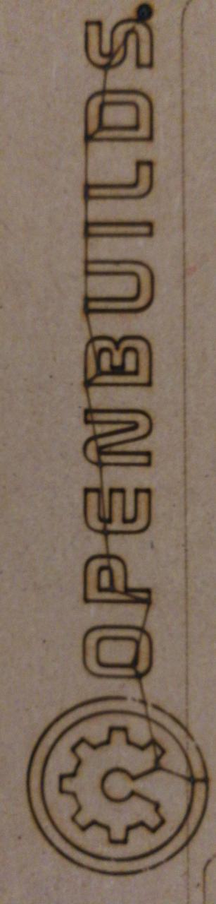

Thanks I’ll try that now. I have to say the $32 code is a very nice feature the cut on the right you can see how the paper was burnt but horizontal one is with laser mode enabled. It’s clean apart from the incomplete cuts https://plus.google.com/photos/105701171799483912820/albums/6492628885434347617/6492628891380350754
