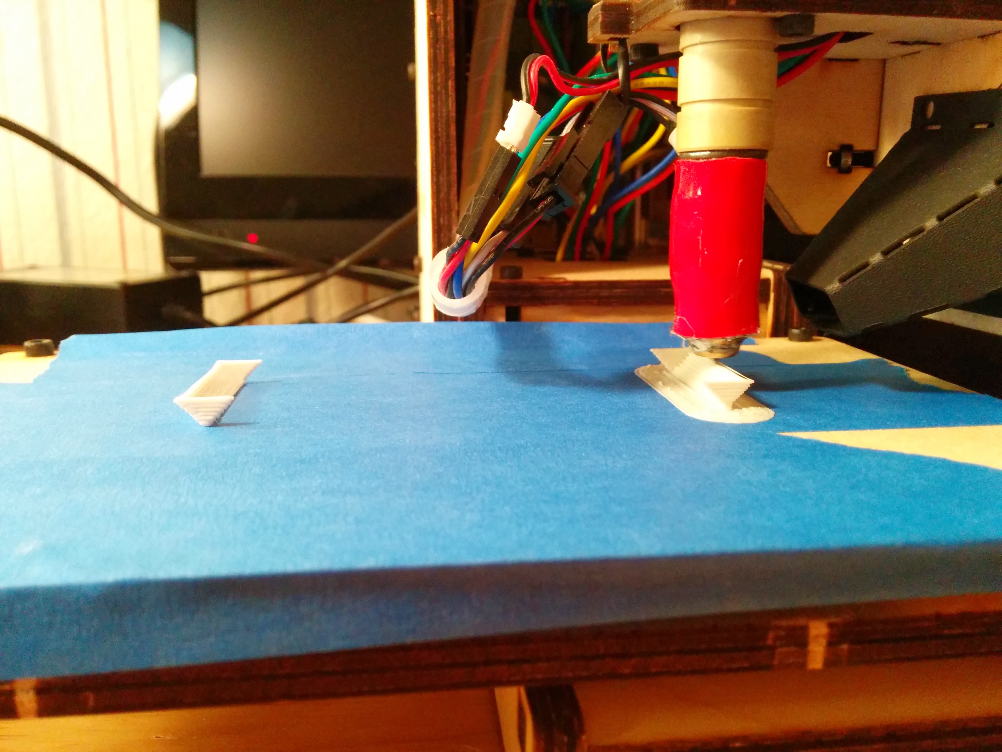

How can you force Slic3r to put a brim around all parts that touch the bed? I’m doing a print with two parts that will meet in the air. As you can see it only put a brim on one part.

Mine doesn’t do that - do you have some sort of Z-trickery going on? spiral vase mode? are the bottoms of those sections both at a true Z 0.0?
That shouldn’t happen? Is it a model of yours or online?

Most likely cause is that one item doesn’t quite reach true 0. It could boil down to a floating point error.
I think whosa whatsis hit the nail on the head.
Ah. I hadn’t thought if that. I’m not a CAD expert and I did a few dodgy things in my OpenSCAD model, so that’s very likely. I’ll report back.
Looks like the two sides were 0.1mm off. Fixed it. Print in progress.
