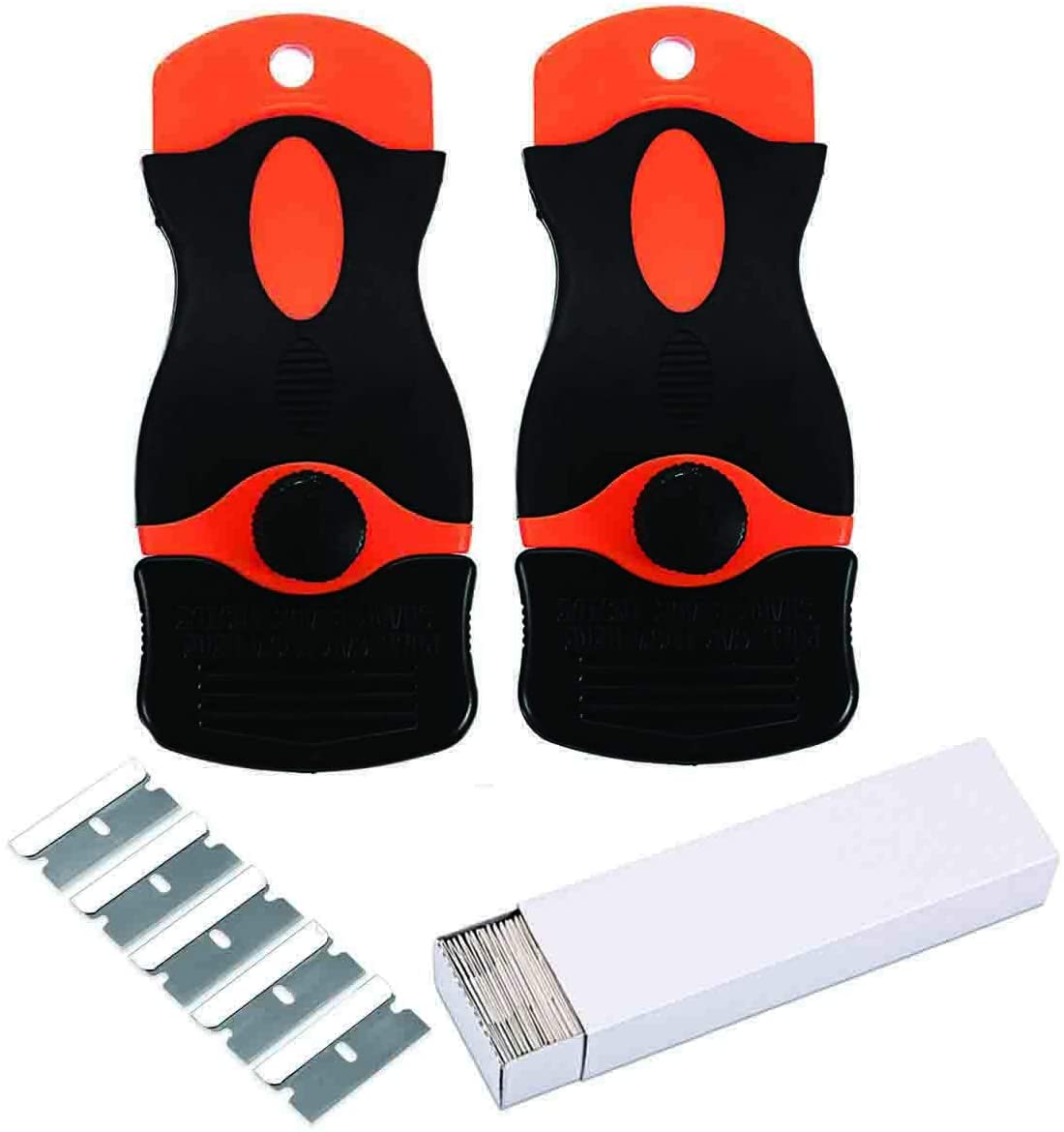

You can also use tweezers to do the weeding but that’s slow. Or a cut vinyl pick tool.
I’ve been playing with these and they are working out really well.
