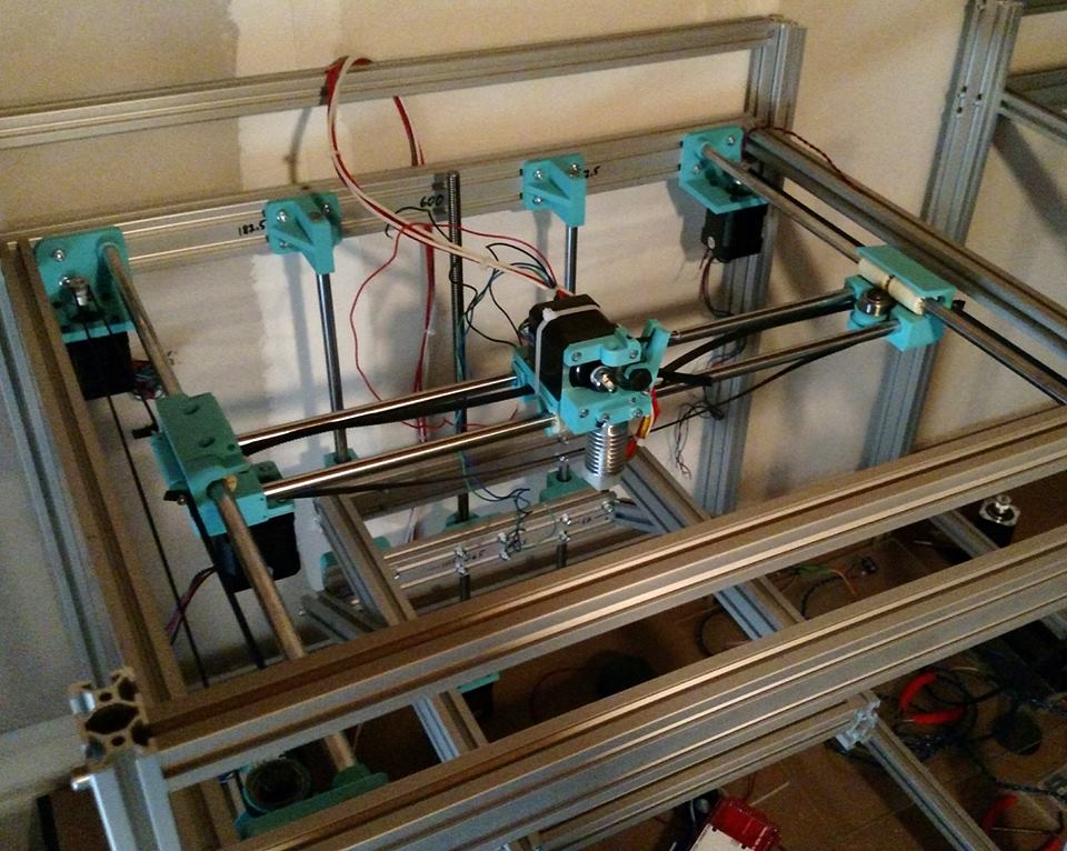

how do I, or can I, switch the output from the y and z motors. IE, i want to have the z axis motor output be the y axis motor output and the y to be the z. I’m using two y motors and the z axis has two outputs. I’m just trying to give myself some options for experimentation on a new design.
i’m looking through the marlin firmware and can’t find a solution (using ramps 1.4)
