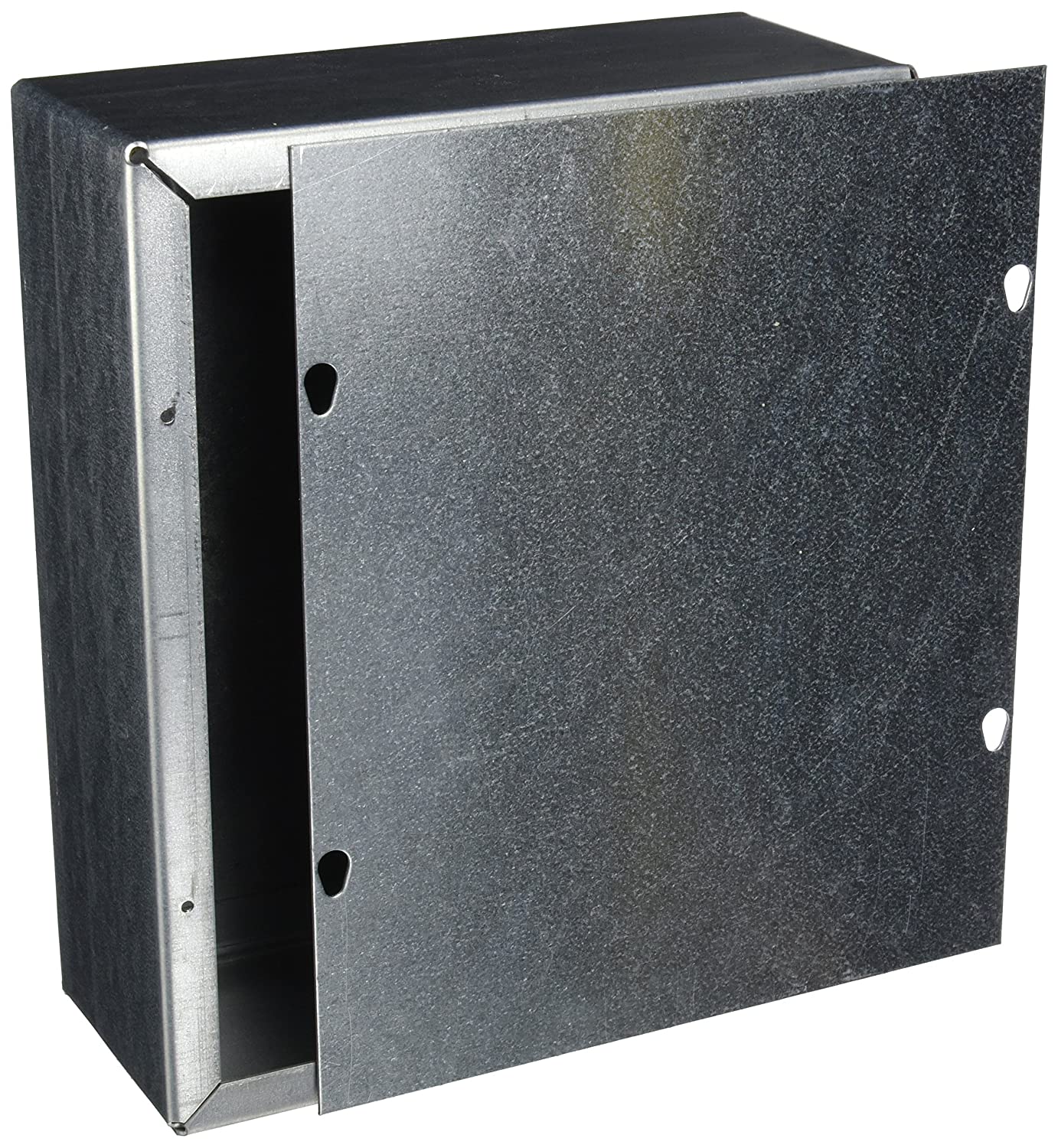

i actually bought a nema1 box from amazon for 20 bucks.
its big. its heavy. but i put my ddcsv1.4 on the lid. its thick so not so easy to cut as i believe its 16ga. my nibbler broke as it handled only 18ga and well i went for it
