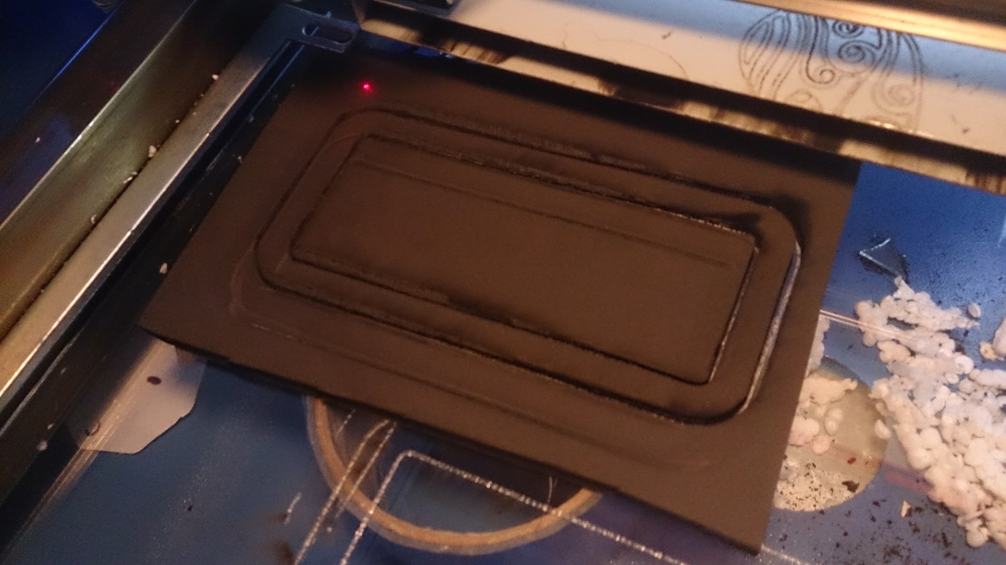

I thought this would be easy enough (3/8 thick “Extra Soft” EDPM), but even after 16 passes at 40W power and 30 mm/sec, it doesn’t cut through all the way. And there appears to be a “ghost cut” approx. 1/2" below the real cut.
If I decrease the speed, I get more fire (which my air assist promptly blows out), but it doesn’t seem to cut any better. I can pierce it with 3-4 shots of 80%+ power for ~1/2 second (by thumb on test button) – if you try to just hold the button down for 1 second, it makes a crater, but doesn’t cut through.
Is this just something that “can’t be done” or what should I try?
Why do I have a ghost beam 1/2" below it for horizontal lines only (and it’s not because the cut went all the way through – the “cut through” portion is roughly 75% of the way from the right – the left was not cut all the way through, yet you can see the line in the inside going all the way across)?

Check out regarding your lens orientation. Concave side facing down. Seems a lot of us have had this same issue.
I’ll double check the lens. Right now it’s convex side facing foam, flat side facing laser. The foam is positioned so that the focus point is on the top of the foam --checked with a 100W LED bulb (I tried it in the middle of the foam thickness, but that worked slightly worse). Should I raise the foam by 1/8" every pass (that’s hard, but maybe I should build a jig)?
So it was upside down and putting the curve upward helped a lot… I put the foam back to focal on bottom, but it still takes 3 passes 20 mm/s 40 watts to almost cut through it… And the phantom burn is still there. Any more tricks?
