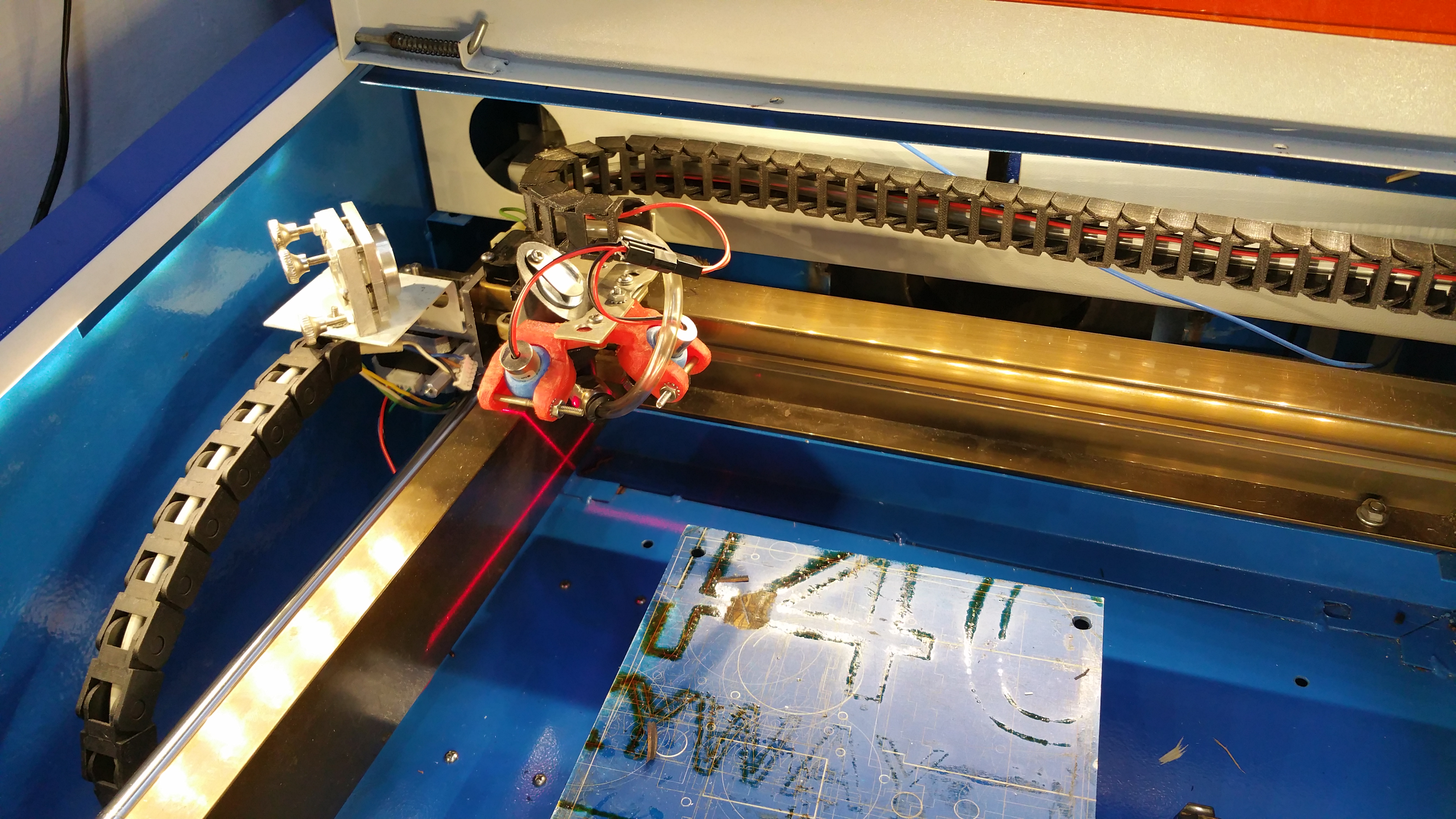

How do you guys hand the air hose to the air asst? Anyone have pictures to show?
some use coiled hose and let it hang, others(like me) use cable carriers for air assist and the laser pointer power leads.
I just made a bracket with a hole in it. I stubbed the air fitting out the left side of the picture and just use the one piece of tape to keep the hose against the wall. The hose is a cheap vinyl hose and kind of stiff but move around freely and doesn’t get caught on anything.
