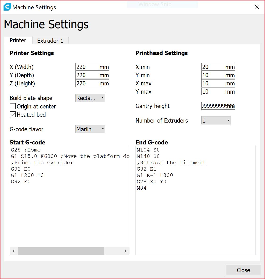

How do you make the printer move the Y axis forward when the print
How do you make the printer move the Y axis forward when the print is done so I don’t have to pull the bed forward? Is it the the line that says “G28 X0 Y0”? If I change that 0 to something like 200, would that work? Also, should it be a positive value? I assume so but I just wanted to ask.
Yeah, a safe bet, is that more positive values are towards the back of the plate. So you are correct in your assumption. I would add an “M190 R” for whatever temperature you are comfortable messing with the bed at before moving it forward.
Personally I would replace ‘G28 X0 Y0’ with a lift 5mm (or less depending on how close/often you max out the print height), then move to desired position:
G91 ; Set relative positioning
G1 Z5 F6000 ; move up 5mm
G90 ; Set absolute positioning
G1 X0 Y200 F6000 ; move bed/head so print can be accessed.
Play with values for the last line to get the head/bed where you want it.
(Edit: Had wrong code for setting absolute positioning)

I use this code:
G1 Z+0.5 E-2 X-20 Y-20 F{travel_speed}
;move Z up a bit and retract filament
G28 X0 Y0
;move X/Y to min endstops
G1 Y250 F3000
;Plate is moved forward
The G28 home makes sure that no matter where you are printing on the bed it moves from that point to present your print.
Make sure the G1 Y value does not exceed the limits of your bed.
