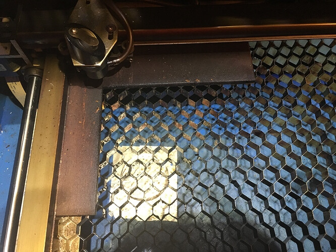

I use an angle that I cut out of MDF. It is important that one’s machine bed is static, that is, cannot move. On the machine bed, I have laid and fixed the MDF plate and cut my X and my Y in full length (actually 400x600mm, which is my max X and Y)
Now I have my 0:0 perfect for reference and for aligning my parts to be machined. Typically I adjust the part with a margin of X+5mm and Y+5mm in LightBurn.

Yes, same here. I have what looks like a set square that sits in the top left corner and proivdes a true X and Y edge. I commonly use 2.5mm margin on the sides of any design/cut to ensure it fits comfortably.
I just found a picture from my co2 laser. Here you can see that there is an MDF strip at the top, and on the left side is an aluminum edge (can’t really be seen) which forms a perfect 90 degree. When I e.g. want to engrave on slate slabs, I have a template that fits that. I save the setup itself as a template file.

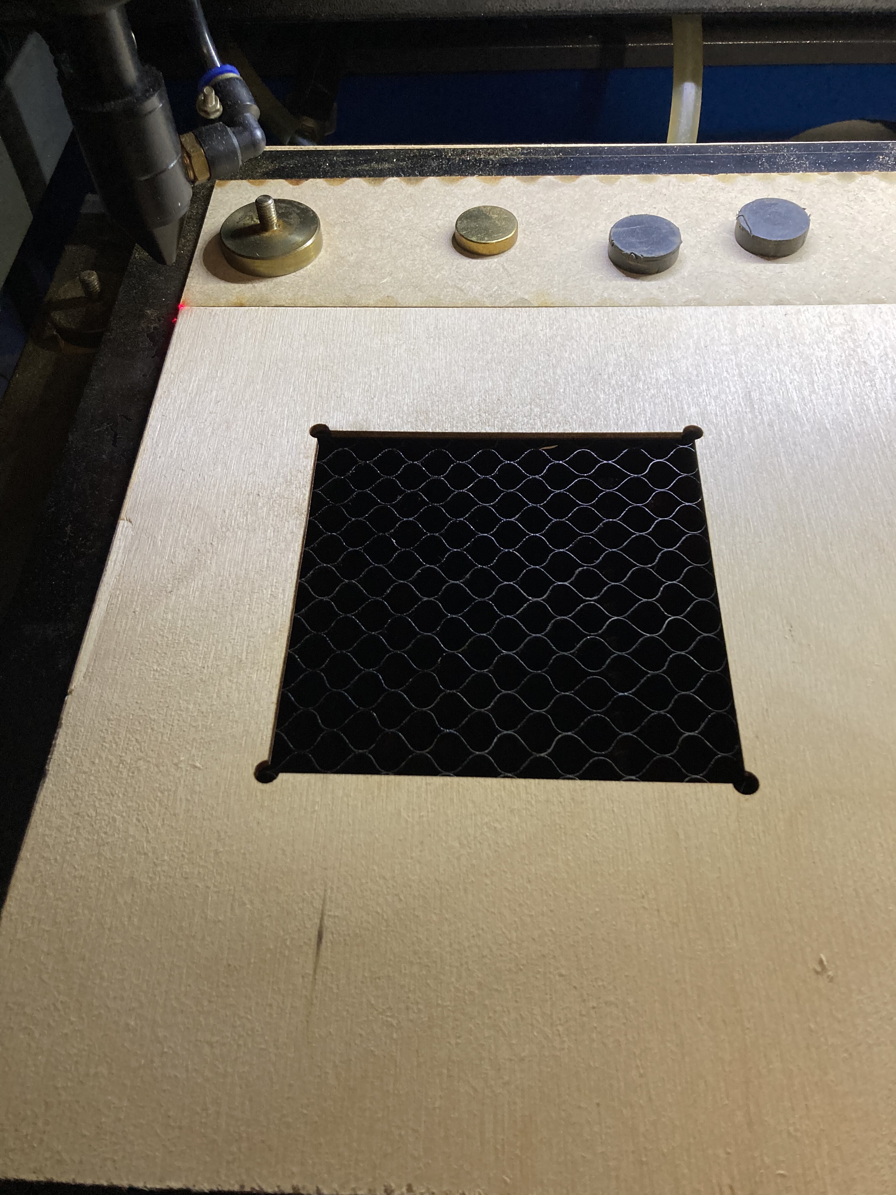

  • With my k40 I have always used an origin Jig which is made from a piece of plywood jammed into the top left corner and then cutting a square L along the axis zero lines. This gives me a precise 0,0 origin to place my work piece and uses absolute coordinates from the origin.
