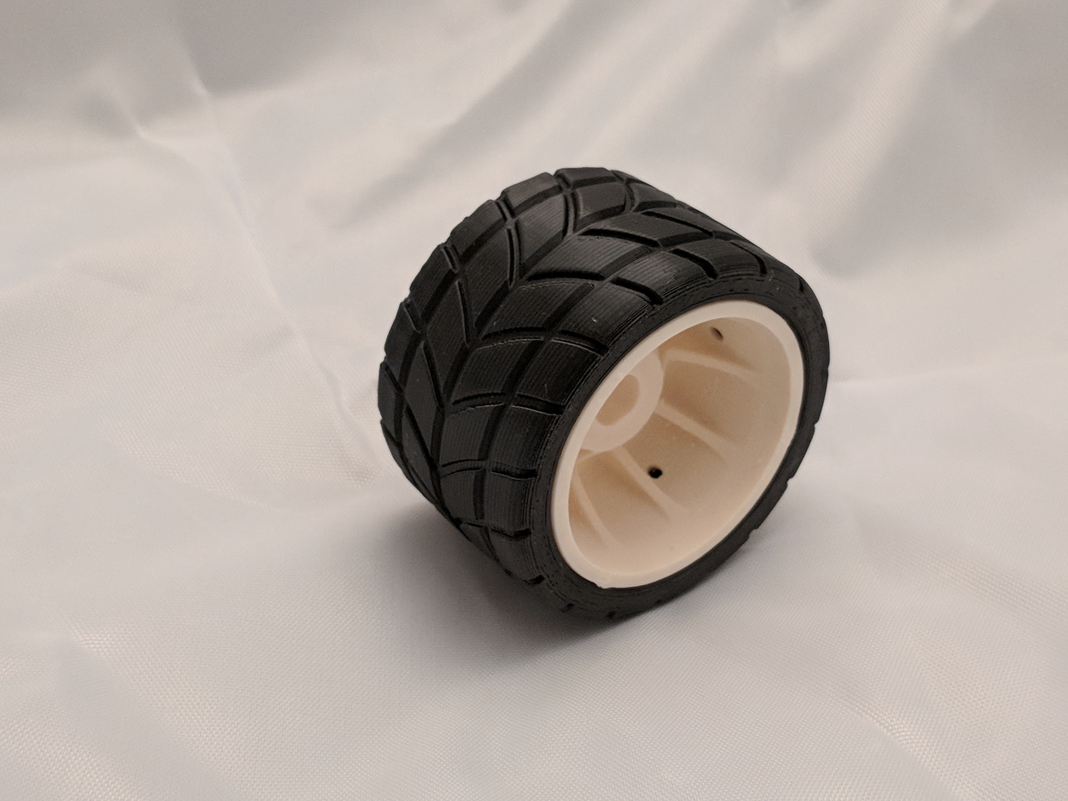

How do you print the F1 tires (specifically, the rain tires from @Thomas_Palm )? I’m using NinjaFlex, I really want to know infill and wall thickness (# layers).
This is 15% infill (overnight, @Thomas_Palm suggested 10%), 2 wall layers, in NinjaFlex with a monoprice mini. 8.5 hours but it came out great.
The hubs are ProtoPasta’s MattePLA, which I may repaint in chrome.
