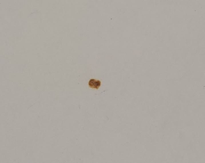

Here is a very short burn from my K40 right at the tube exit before any mirrors.
Does this look normal or is it off?
It could be but the picture does not provide any sense of scale?
Is this spot magnified?
Is there a particular problem you are trying to solve?
It’s zoomed in quite a bit, very small dot when looking with naked eye.
I’m getting a circle outline burn pattern after mirror 1 so I’m trying to figure out if its the tube and maybe get a replacement from where I bought this unit.
That appears to be a normal pattern from the tube. No TEM* pattern.

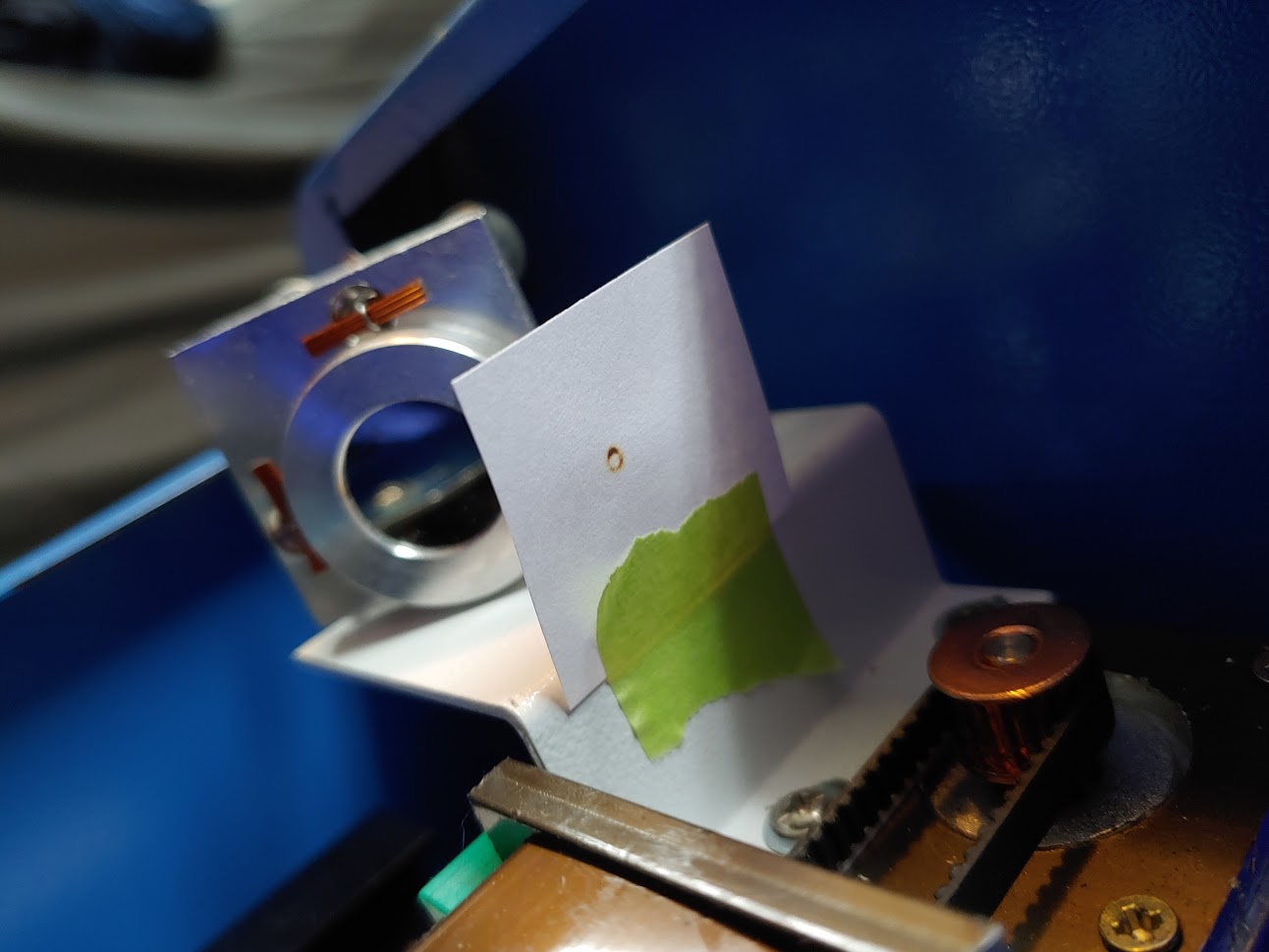

So it’s normal for the pattern to change into a circle outline after it hits a mirror?
This pic is closest after first mirror.
No, the pattern should not change. The shape of the beam should not be affected by the mirrors. If the burn pattern is a solid circle coming out of the tube, it should be solid everywhere it hits and be reflected as a solid circle.
A good test would be to swap your mirrors and see if the shape persists.
