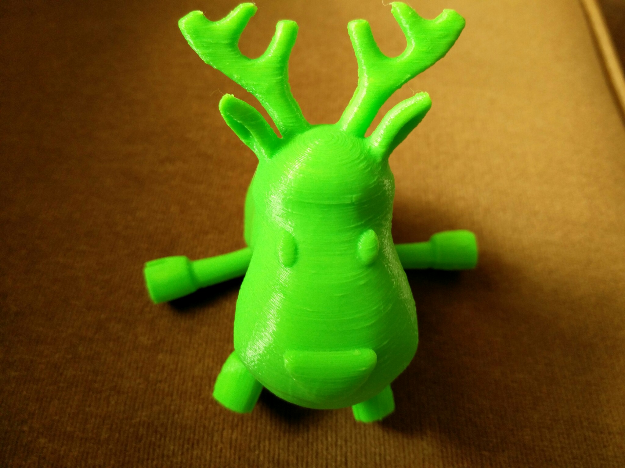

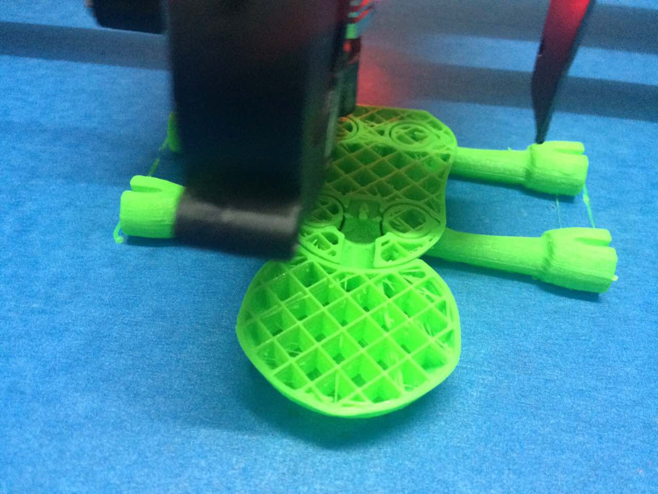

How does this look like to you? Overextending?
Overextending?
1.5mm layer height
PLA at 195Deg
60mm/s print speed
3mm retraction at 40mm/s
Increasing speed of travel moves should reduce the stringing.
looks like to hot a print temp to me, possibly PID tune issue, possibly just mediocre quality filament extruding unevenly.
I’ll try lower the temp a little more.
I’ll also redo the PID for the hotend.
Higher temp might help. Maybe more retraction (or fixing retraction errors like a loose bowden tube not connecting tightly). I think its mainly due to over extrusion.
Looks like I’ll have to try both lowering and upping the temp…
Bowden is properly fixed on both ends.
I’ll try lower the extrusion multiplier a little more
Update, print is finished
