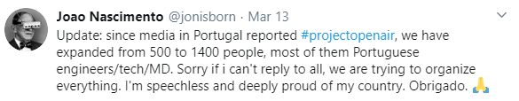

There is already a group on this :slight_smile:
This would be cool to work on …
That seems like a dead end. However, this seems to have borne fruit:

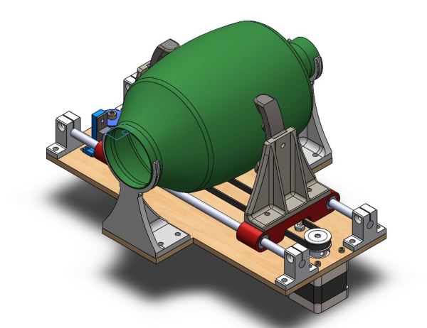

After reading all these references this is the net of the challenge:
I think this design is all about the sensors to accomplish this control…
Further, any low-cost ventilator system must take great care regarding providing clinicians with the ability to closely control and monitor tidal volume, inspiratory pressure, bpm, and I/E ratio, and be able to provide additional support in the form of PEEP, PIP monitoring, filtration, and adaptation to individual patient parameters. We recognize, and would like to highlight for anyone seeking to manufacture a low-cost emergency ventilator, that failing to properly consider these factors can result in serious long-term injury or death.
