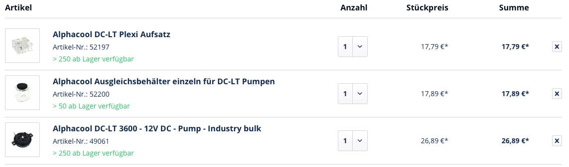

And for the pump/reservoir I recommend this, but you can go with any other setup, cheap or not, too.
and if you are only looking for most bang for buck and therefore China is no problem for you, I think you can do the complete setup for less than 50$/€
