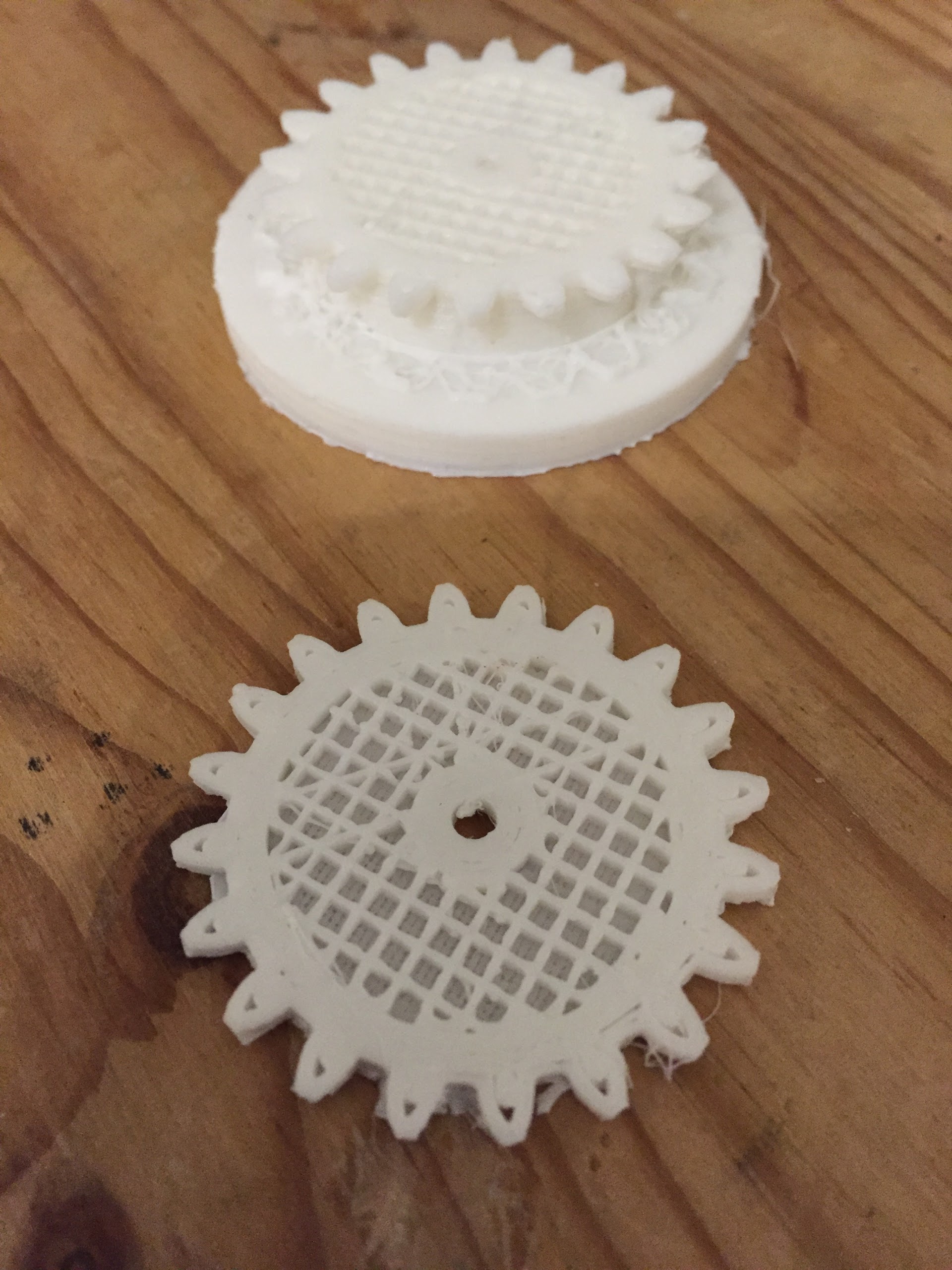

How many of you have printed a gear and worm drive set?
How many of you have printed a gear and worm drive set? When printing the worm drive was it laid out horizontally or stood vertical? The gear prints fine but worm drive is always a mess horizontal even with support material so the print gets aborted early. Maybe I need to slice in something other than Slic3r? Or give up with gears and switch to belts.
