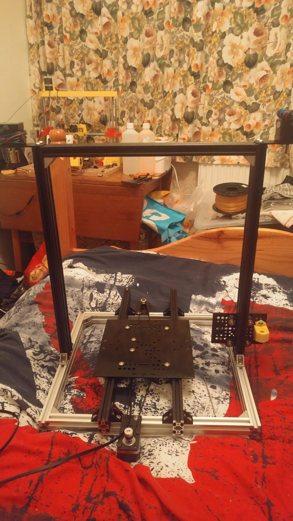

Yep building a printer off the cuff is definatly more expensive. Ive used all open build stuff 2040 extrustion. Im in at about 400 quid at the moment. But its definatly more fun. And this thing will last forever and take a beating.
@Jonathon_Thrumble keep at it man, your design is similar to what I built!

@Joe_Walters nice. Just wanted something sturdy. Only need another 2040 for the x axis and im there.
