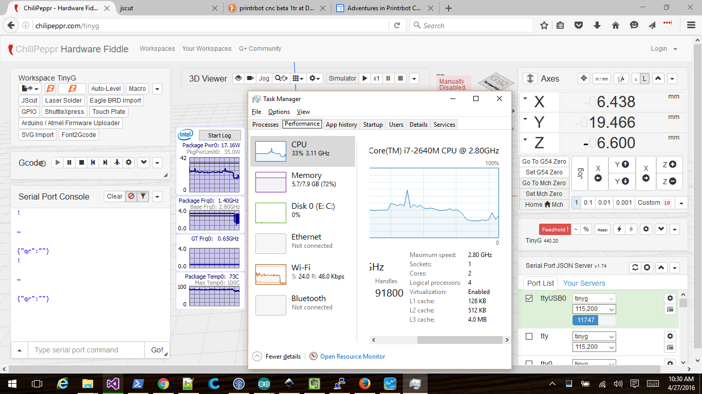

How should I troubleshoot chilipeppr connected to tinyg (printrbot CNC beta) with tinyg updated last week and serial port json server 1.80 just stopping.
feedhold then resume (~) seems to get it going again, but I shouldn’t have to babysit this.
I’ve tried turning off 3d preview and serial console but it will randomly stop moving (with buffer) or pause gcode sender.
I’m currently testing with no bit and the spindle off because if I can’t run a job that takes over an hour I might as well not be using chilipeppr.
