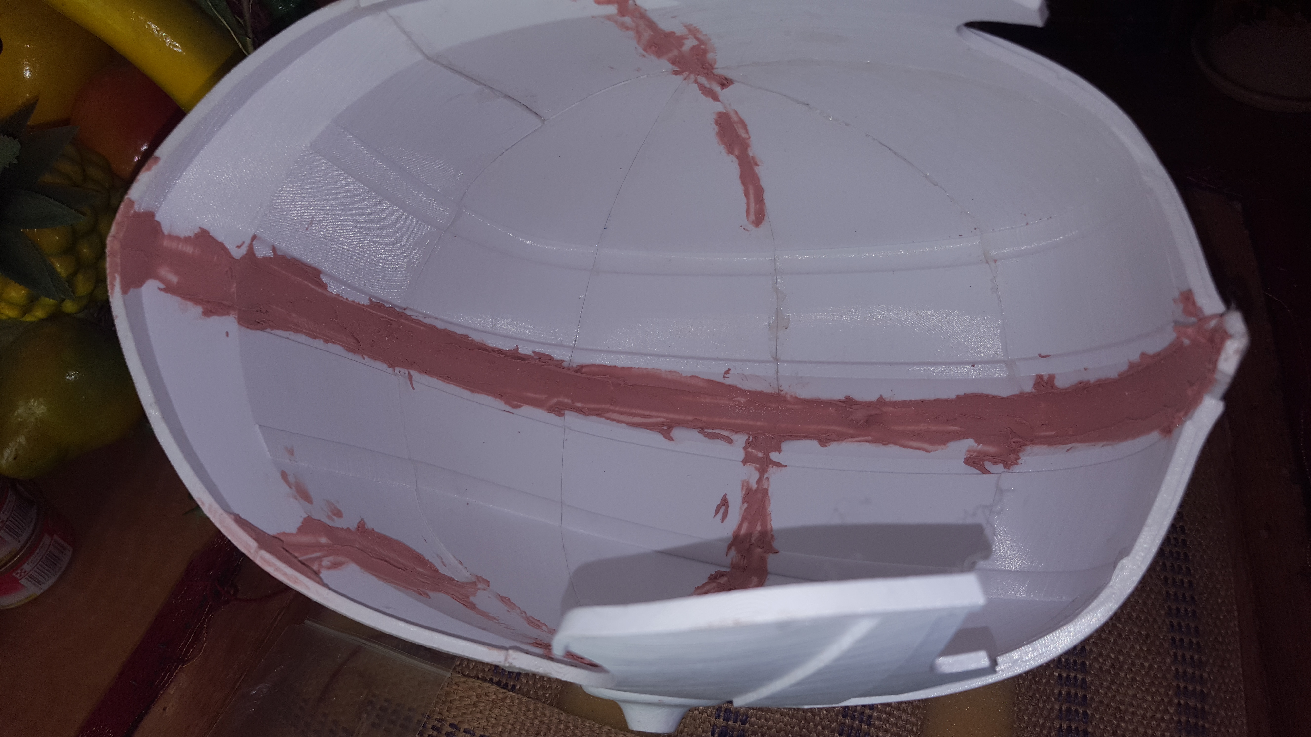

How the heck do i get sand paper into the inside of this helmet
How the heck do i get sand paper into the inside of this helmet without breaking it. Bondo is as hard as stone lol
Dremel with a stone.
Dremel. You know i have 1 of those somewhere in my mess of a room. Thanks! :slight_smile:

@michael_hughes Bondo does not repair car bodies, it is used to add styling features such as grooves and lines in automotive bodies, panel vans, or smooth out uneven areas or rough patches. Bondo on an ABS or PLA object is too hard and sanding will remove more of the softer plastic than the bondo. Using a dremel tool with a sanding drum will lead to more gouges in the plastic, but if you have to grind it down, that’s the method you would have to use. Using sandpaper and your hand will sand down more unintentional areas than wanted areas. Using the dremel tool you will get kick-off, that’s when the tool grabs onto a peice of bondo and goes skidding across and damages an unwanted area. You can use aluminum tape, or muffler tape to line either side of the bondo to prevent that damage.

whoah whoah whoah… hang on a minute, this is INSIDE the helmet!
You don’t need to sand it do you cos you’ll be putting in some padding, right? so the padding will sit on and over the seams?
Yeah but i wanna get the rough patches out so they wont poke me through the foam
Ok, so as MidnightVisions says, tape off the plastic around it so when the Dremel skids (and it will skid) you can knock off the peaks, then use a torn off piece of sandpaper to rough down and partially smooth. That should do.
oh, and keep the Dremel set to a low speed, will be easier to control.
