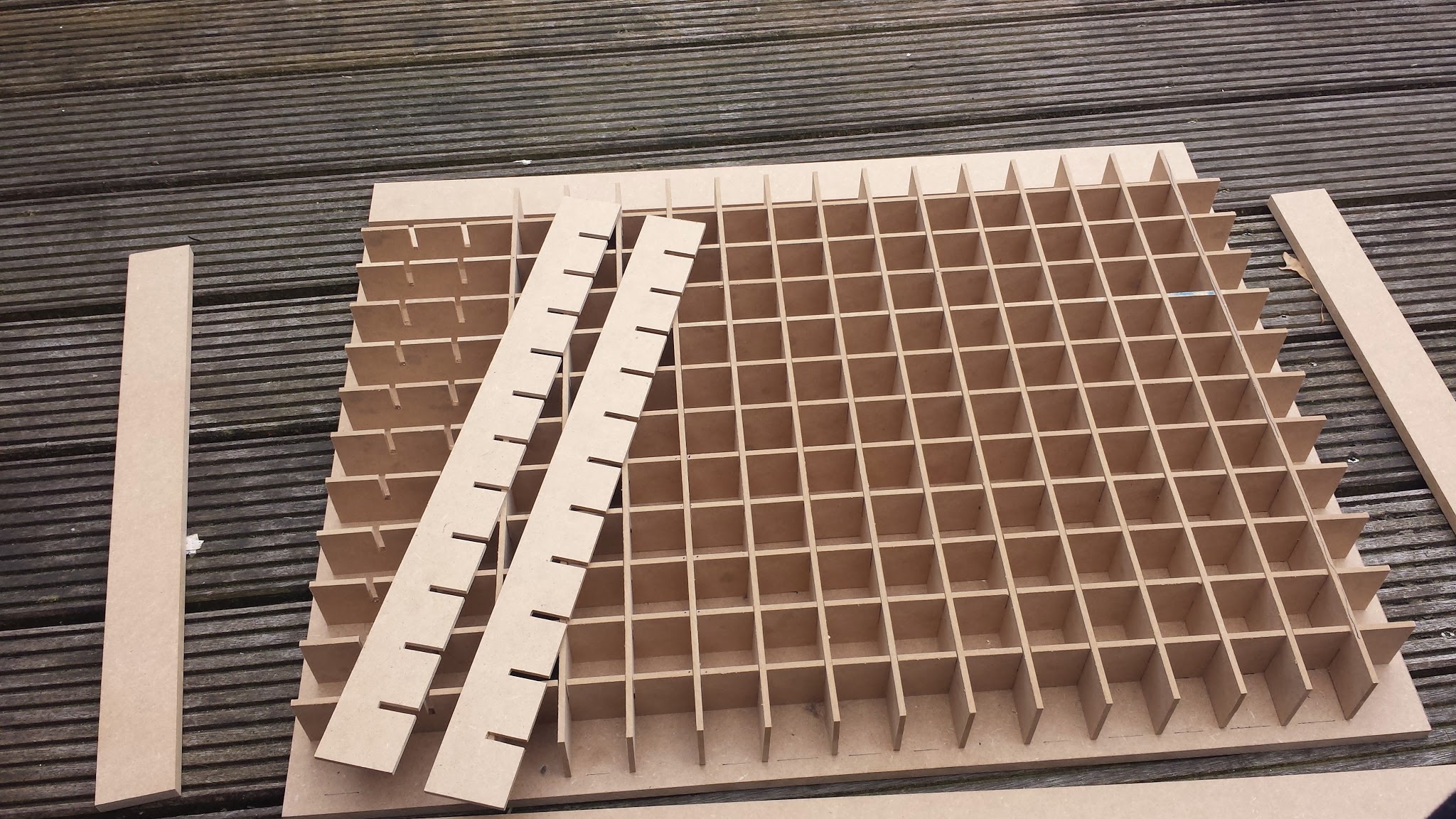

How thick is the lpd8806 led strip without protective sleeve? I need to know because I need to route some channels in mdf for my led table and still not received the led strip from China…
I couldn’t wait and routed 3mm deep channels for the led strip I hope it is deep enough…
