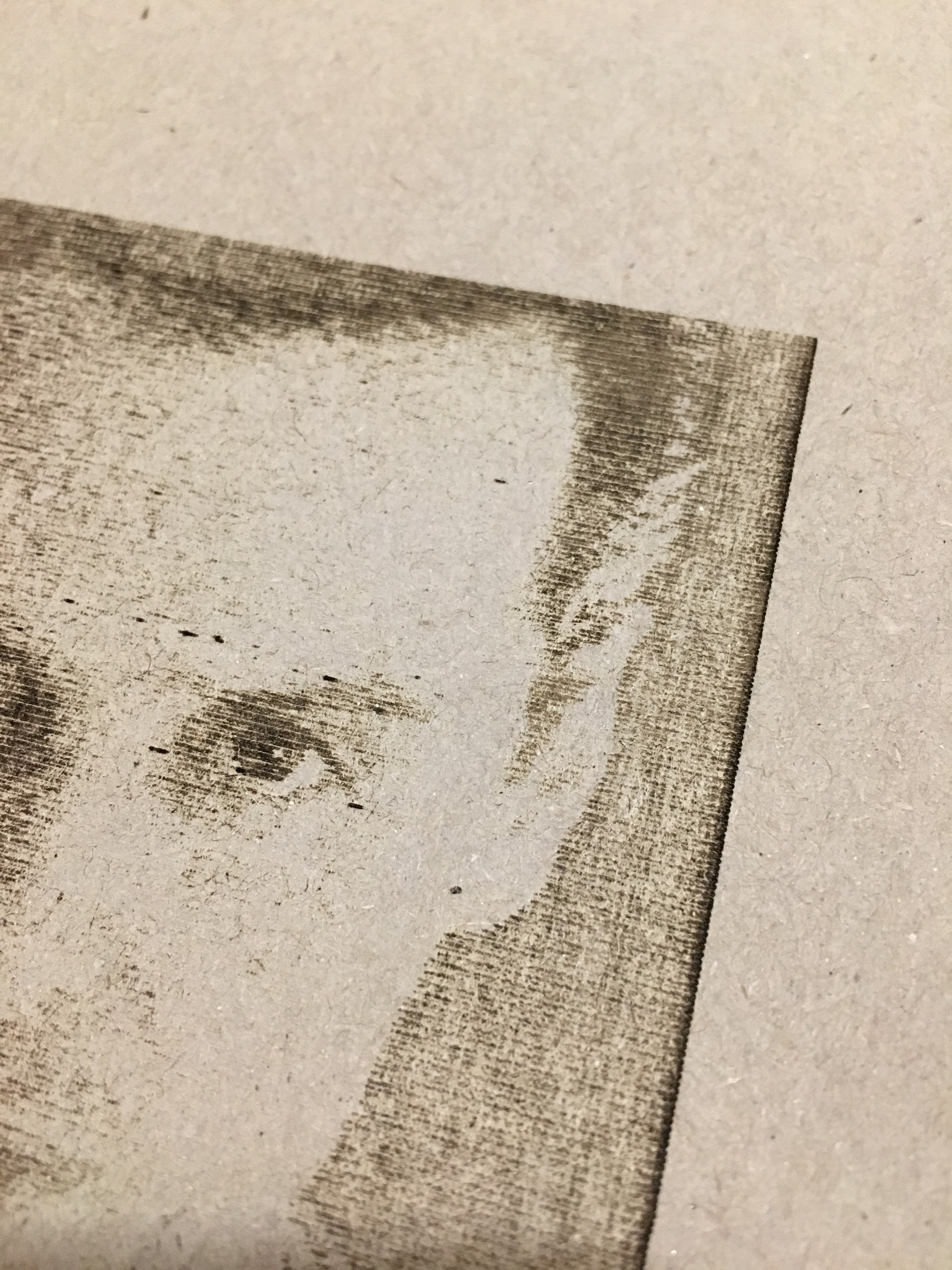

How to avoid the black edges?
Laserweb3 - latest version 30477 (git pull)/GRBL 1.1e
And Chrome is very laggy. Hangs during engraving.

I think it is a problem of feed rate. If my feed rate is over 50mm my arduino loose some steps (see my next post) and then chrome hangs too!
