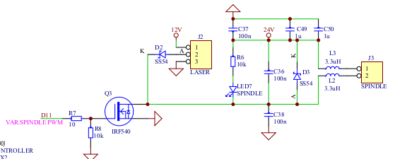

The board I am using is a woodpecker clone. The schematics seems to be similar to this:

Unfortunately, since all the pins on the board seems to be default low… and some dumb guy decided to make the K40 PSU fire on low! it is not helping…
What are your toughts on connecting the PWM output to IN and the L pin low directly or through an extra on/off switch for safety? I know that I would loose the “double PWM control” which allows for easier max power management, but I am ok with that…
If I have to go the PWM inverter route, do you have any reference/suggestion on what mosfet and resistor to use? I know electronic “theory”, but not enough in practice to make such choices…

This is the output of my Woodpecker controller for one of the 3018 types, probably similar to yours. You want J2 pin 2 to drive H input, that is the inverted L input… if your lps has an H input.
pwm-woodpecker-3.2

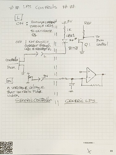

Here is some technical info that may help you decide which of your options works for your situation.
Although I have my recommended approach I will endeavor to give you the technical information you need to make your own.
This sketch shows the equivalent LPS input circuit.
As you can see neither of these inputs is really “TTL”. That is in spite of what the manuf. specs tell us.
The L input expects as ground which creates current through the optocouplers LED and saturating Q1. Q1’s on-state enables the PWM in the LPS. The LPS internal PWM generator is controlled by IN.
This approach isolates the L signal from the HV supply and is not susceptible to voltage variations. This approach, also used for the P and K controls, are effective ways to interface a control switch to a hostile device.
The IN input expects a DC voltage and that value controls the pulse width of the enabled PWM controller (simplified explanation). This input is not isolated from the supply and as an analog control is susceptible to voltage variations dependent on the voltage and frequency of the signal.
Since a PWM signal is a two-state signal it can effectively control the LPS by pulling the L signal to the ground. This can be done using a MOSFET driver like Q3 in the schematic above. This produces a noise-free and isolated control of a HV power supply.
A PWM control signal has been shown to be able to control the LPS using a PWM signal on the IN port. This will work if the incoming signal provides a DC swing that is enough to switch the pulse width control between max(always on) and min (always off) pulse width. This port does not provide isolation and is suspectable to frequency and voltage values.
Your supply type does not have an H and L control only the L control.
If the GRL firmware switches Q3 to the on state when the PWM signal is in the high state, using Q3 as an open drain will work.
I vaguely recall some kind of inversion problem with GRBL but I do not know the configuration that occurred. A search of this forum could shed some light on that.
I also recall that the PWM signal direction cannot be changed in the GRBL firmware.
I hope the above info will help you decide your approach.
