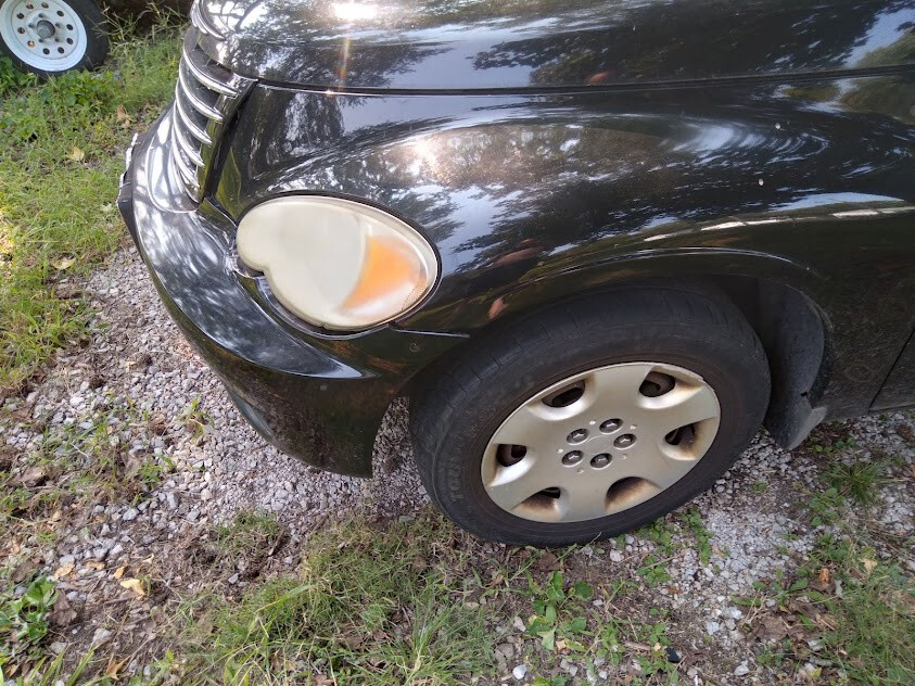

How to fix a PT Cruiser bumper cover that detached at the side

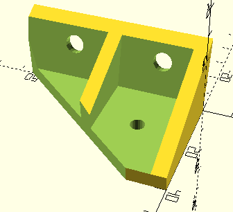

or maybe even a little better because I had a few design iterations since then.

There are some screw holes along the splash guard. If those have the holes ripped open, that is another matter. This part will obviously not help you re-attach the splash guard.

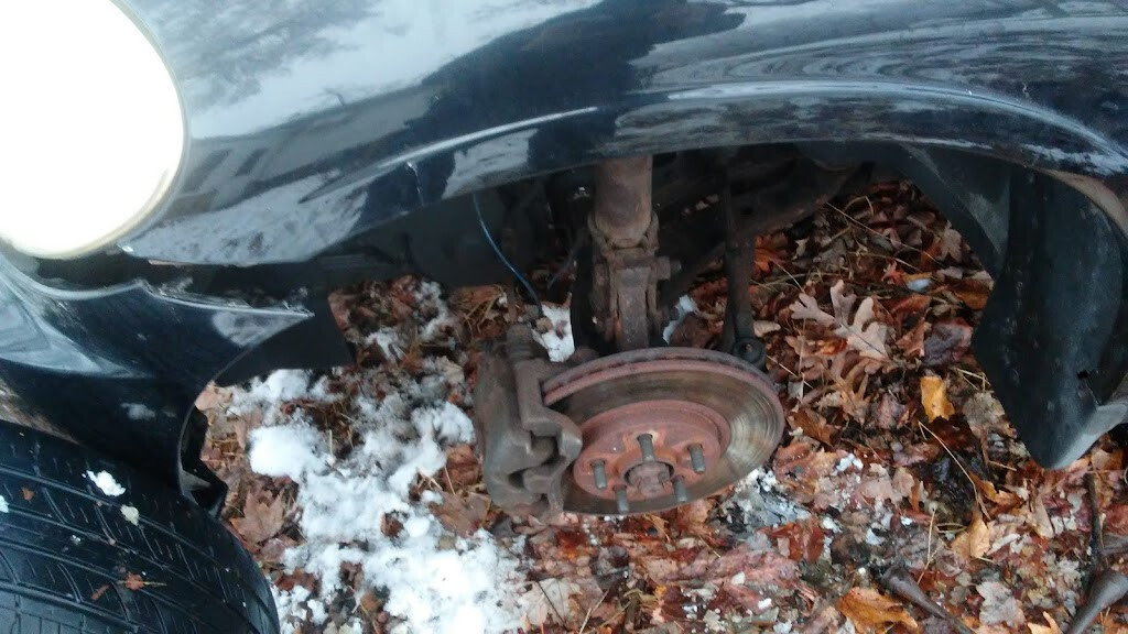

The wheel was off for a totally unrelated matter. You do not need to take off the tire to do this fix. It is convenient to have the splash guard at least partially removed though.
