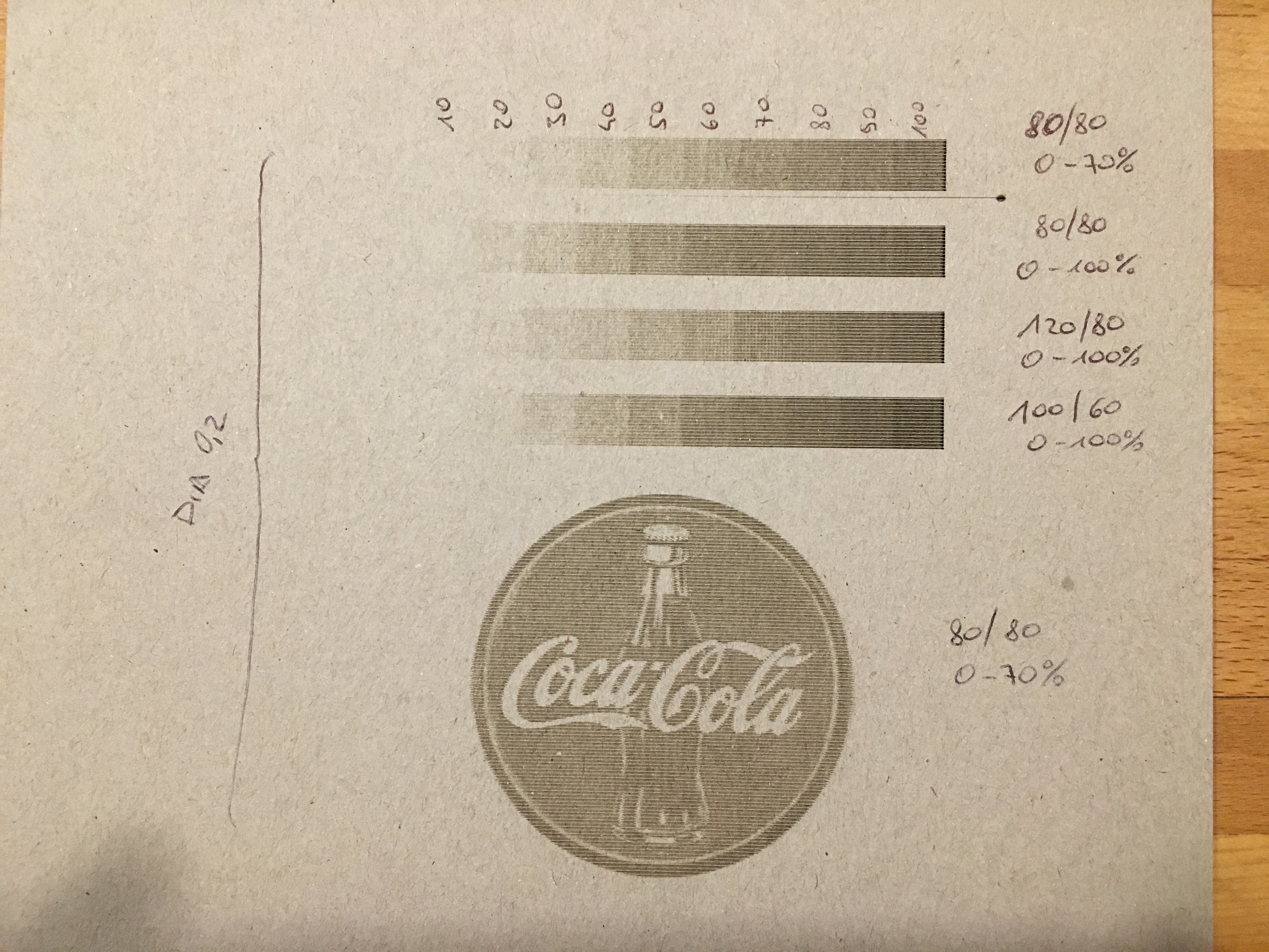

How to improve greyscale engraving around 10-30% and 70-100% with Laserweb3?
2 Watt dioden laser.
Not yet, unless I missed a lw-rasterizer option
I have found some materials will preform differently over certain power ranges… I think some of it is due to the ignition point of the material … And at lower powers like a 2w would require a slower feed like +Peter van der Walt suggested with the power to acceleration adjustment found in Lw3… Just out of curiosity have you experimented with any other material @Walter_K_opaque ? I found it very hard to get light tones on pasteboard like what’s found on the backing of spiral notebooks
That grayscales allready looks quite good for a diode laser. Play with the black speed and white speed values to strech the scale a bit more.
Try speed differences in both directions (faster black speed and slower white speed, and vice-versa) as it depends on the material too.
+Peter van der Walt did i miss somthing? has there been a fix to the slow rastering?
