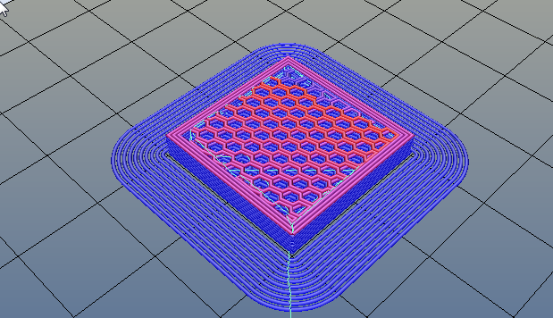

How to increase the size of Honeycomb, So I can reduce the time and filament.
FYI - I am using Slic3r
That would be the infill setting. 0 is no infill and 1 is solid so .2 maybe OK for that.
@Wayne_Friedt I want to increase the size (or else no. of) hexagon. bigger honey combs. Will infill do - Will try it any way
Yes to increase the size of the honneycomb lower the infill number
Under Infill, I have tow option
Infill every: layers
Solid infill every: __ layers
I tried both, but the honey comb size is not changing.
not correct place that i am talking about. Look for fill density and change it there
Thank you very much, that worked …
