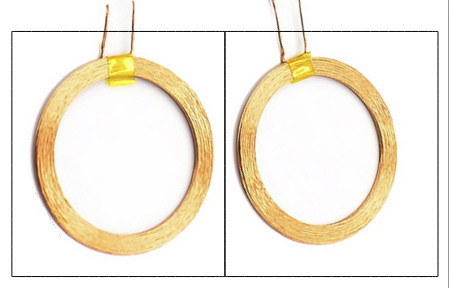

I have two 5V wireless charger (two transmitter) and would like to have 2 charging station.
So the 2 coils will be placed horizontally and at z=0 but close about 10mm.
coil
I’m worrying about interference between the two transmitters.
So thinking to build a magnetic shield around (bottom and sides) to isolate them and concentrate the energy to the top side only. Event this charger have only 20mm max of charging distance, I like to be sure the magnetic field won’t affect any the performance of each other and do not disturb any other equipment that may be close.
How would I do that what kind of material? I hear about copper or aluminum…
Thanks
