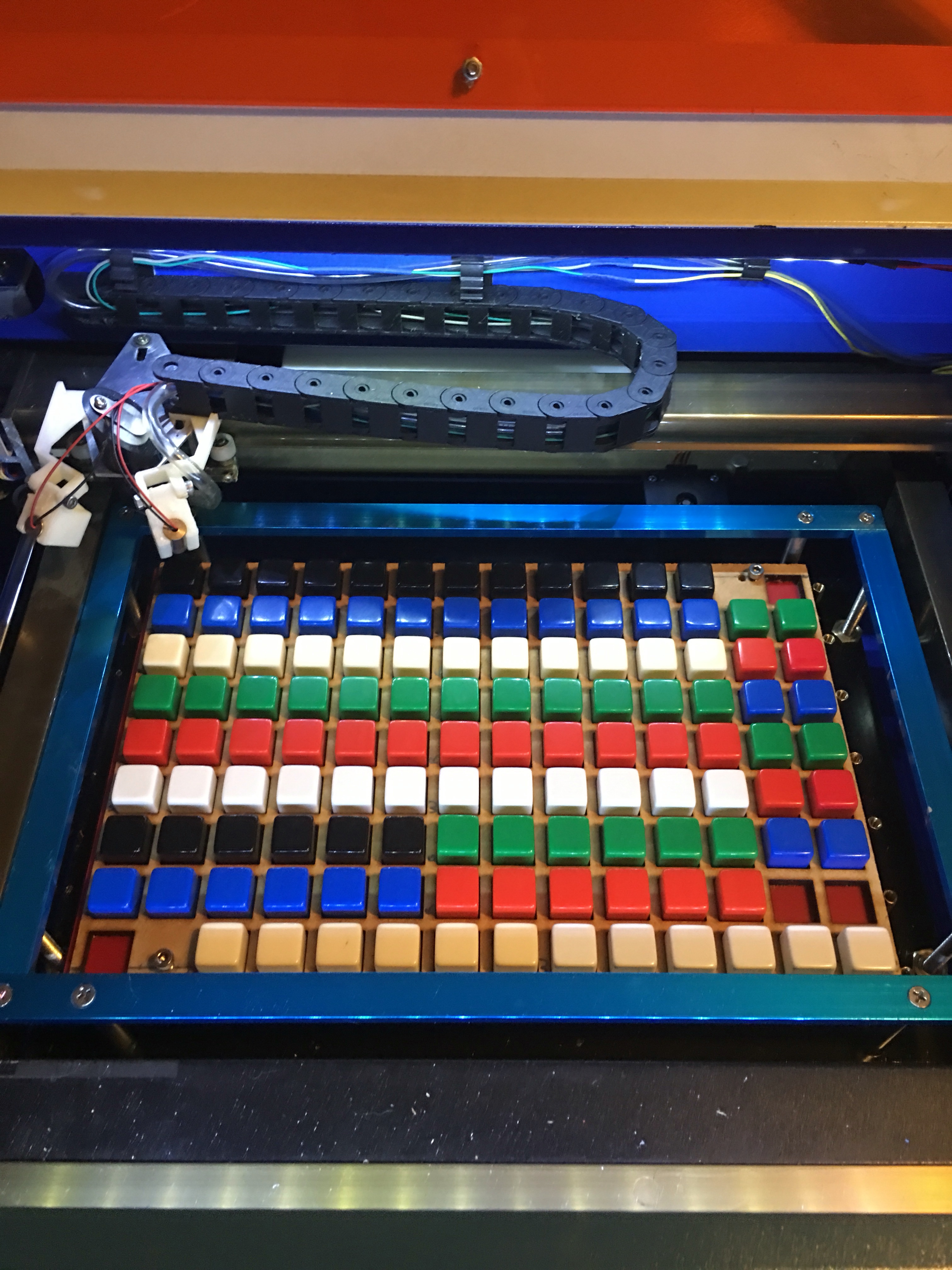

How to make 124 custom dice with a k40
Nice cable management of your air assist and diode power wires :slight_smile:
Please post your finished results really like the work holding you made as well
Looks good. I’d also like the see the finished result (of at least 1 dice).

Thanks for showing @Derek_Schuetz . They turned out pretty cool. What kind of paint did you use to fill in the engraves? & did you seal with something also?
I used sharpie paint pen for the gold and the black is crayon. No seal on it I tried other paints and polishing but couldn’t get good resulys

could you tell me what the dimension of the cable management chain you have?
The one I order is to big and like to but my air lines and wires in one to keep them out of the way.
