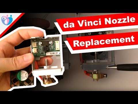

How to replace nozzle on da vinci 3d Printer.

@Neal_Grieb I couldn’t do that because my nozzle wasn’t heating up, therefore the filament was just stuck there. Believe me that was the first thing I tried. Other then the nozzle crapping out on me I’ve been satisfied with it so far. Sometimes the print starts out crappy, like you gotta monitor the first layer but once that’s passed it usually prints out a decent print.

@Neal_Grieb My longest print was probably around 15 hours that was successful. Right after that one I did even bigger print that estimated to be about 20 hrs but that’s when my nozzle crapped out 2/3 of the way and the print never finished. I’ve seen people remove the connector and just hardwire the wires instead and that seemed to be working out for them. I might try that if I start getting problems. I wish I had more time to play with my printer, between family, work and trying to put something on youtube weekly, I don’t get much time to actually design and print stuff as much as I want too.
