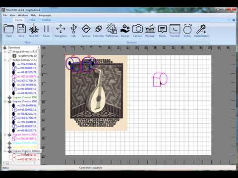

The easiest way to do this would be to make your operations for your material. And just save that as a project. So you would have your plywood settings. And save those. Then you’d use that set of operations when you run some plywood by simply opening them up with a basic drag and drop.
Took me a bit. Turns out making the video hit a snag when the loading had a bug. Apparently I goofed and bool('False') == True. But, shows the correct outline for how this works. You’d also use notes for setting things like your expected knob settings etc.
