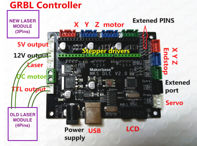

Capture d’écran 2020-05-20 à 22.37.12
My old laser module (2.5W) have 4 pins.
My new laser module (5.5W) have only 3pins.
I suppose the 3 pins of the new laser module are +12v, GROUND and PWM+
So where do I plug de PWM+ ???
Thanks for your help.

Could the wiring be this?

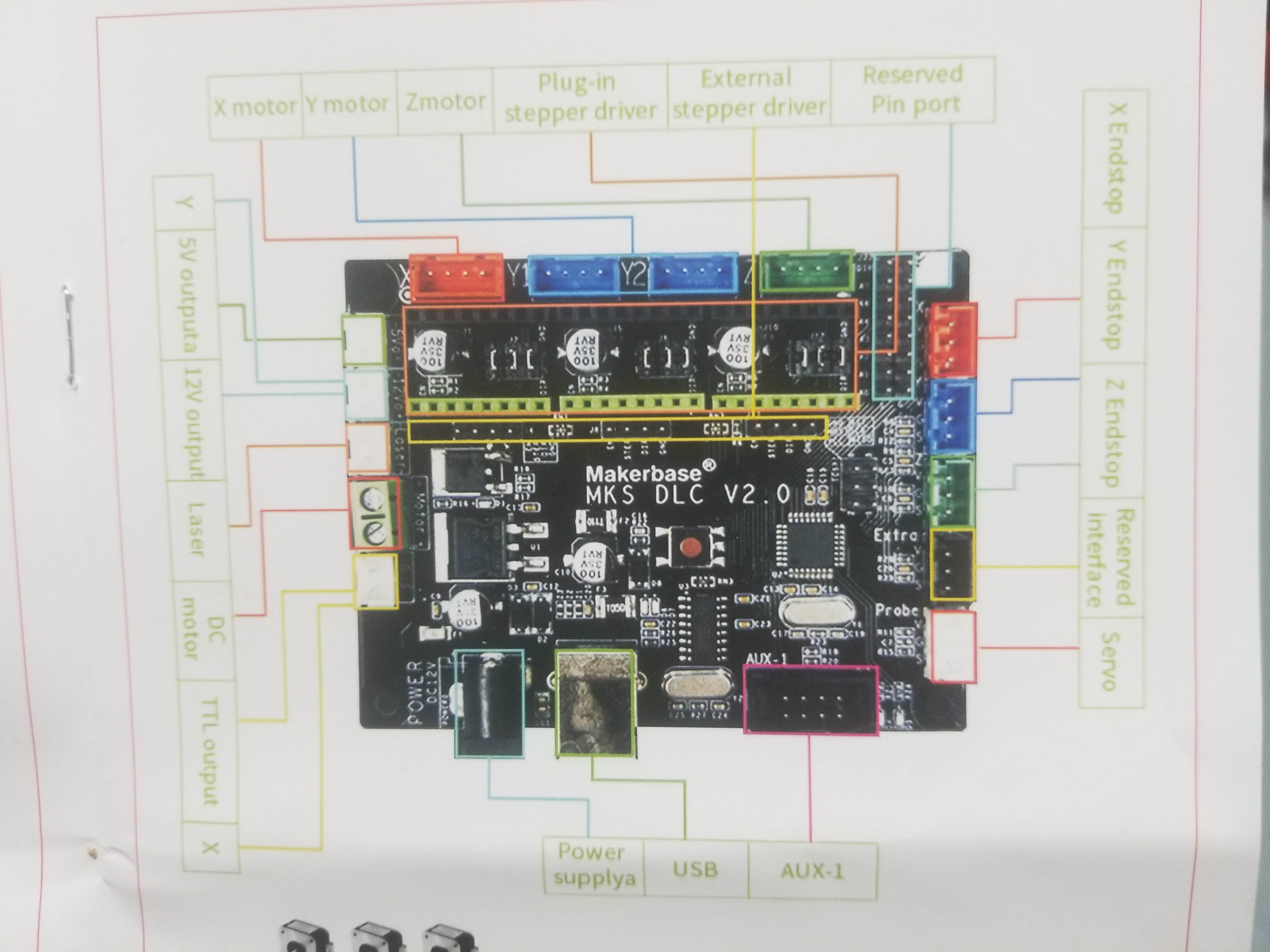

here is a picture of the card manual :

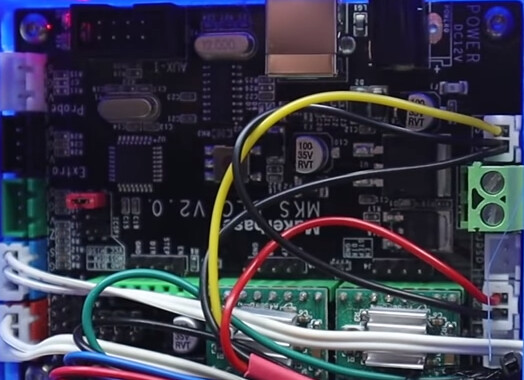

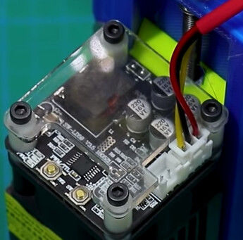

Hola, espero esto te sirva el láser 3p y su conexión a la MKS DLC V2.0. TTL-G puenteado a Tierra.
Por otro lado tengo la misma placa y quiero conectarle un láser 4p, me puedes indicar como lo conectaste?
Saludos.
Este es el láser 3p
Translation:
Hello, I hope this serves you the 3p laser and its connection to the MKS DLC V2.0. TTL-G bridged to Ground
On the other hand, I have the same board and I want to connect a 4p laser to it.
Greetings.
This is the 3p laser

I have a 30 watt LED laser, similar to your picture. I also have a couple others that I’ve collected. All of the current lasers I’ve dealt with are simple 12 v, ground and a ttl signal, usually PWM if you want to vary the power output of the laser. I don’t know that board, but looking at this shot, I think you have the TTL control backwards. I.E. I am suspicious that G and S are acronyms for G(round) and S(ignal). I suggest you use only the 12 v connector for power and the S or signal line as the PWM or TTL control line.
You need to refer to the manufacturers documentation on input/output characteristics of all devices you wish to interconnect.
Most electrical equipment shows ‘input power’ and although relative, not a great way to measure for the user, but required when wiring something up. My 30 watt (2.5 amps ‘input’) is estimated to be a little over 7 watts output. My control board would not supply that much current via it’s 12 v connector, so I added another power supply specifically for the laser.
