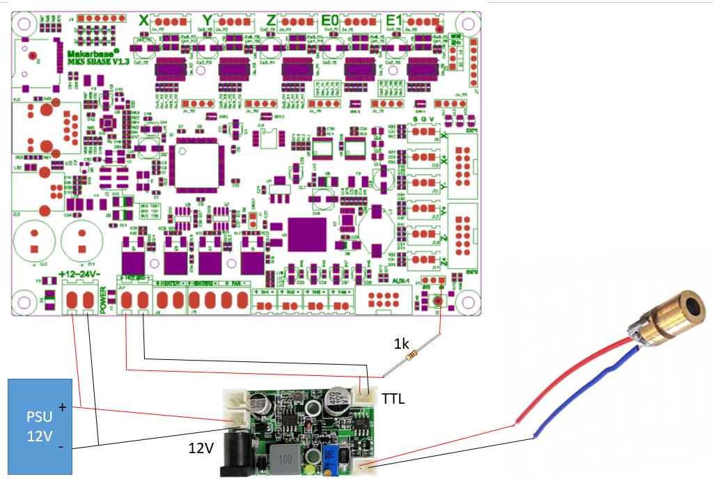

I made a quick and dirty wiring diagram. Can you have a look on it, if i understand everything right.
Thanks a lot.!
Wiring sbase1.3-laser|690x472
Looks right to me although I do not know which are + & - on the driver board, but I am guessing you do :).
As my post suggested I would test it on circuit at a time :)!

Wait… I have had a look to your wiring diagram again.
So, did you wire the 5V J4 with the resistor to -J17 as a voltage divider?
On my diagram the 5V J4 is wired to the +J17.
So i changed it and now i can control the laser power, but in wrong direction. S0 = Full and S300=off
Does that mean i have to use P1.23 instead of P2.5?
The resistor pulls up the output of Mosfet Q4 (pin2*) to 5V, its not a voltage divider. The schematic does not show if pin 2 is the + or the - pin on the “Hotbed” mosfet. My guess is the + on J17 is connected to VBB (12V) not the mosfets output. I think your right the - pin is the output you want.
My screw up #1: in that I did not notice on your drawing that you have a black wire connected from J17 to the laser driver board, that is wrong. Only one wire will be connected from J17 to the TTL input of the driver.
You can verify if the correct pin is the - or the + of J17 by tracing and verifying if it is connected to the drain of Q4. You can also measure the voltage on the + pin with power on and nothing connected to it. If its connected to VBB it will read 12vdc and this is NOT the pin you want.
I do not know for certain but I think the + is probably connected to the boards VBB (+12V) so the - is the correct connection.
Do not connect anything to the other pin on J17. [I assume that is the + pin]
*My screw up # 2: J17 does not have 4 pins :neutral_face:. It has two and they are labeled 1 and 2 in the schematic. I did get the mosfet # right as Q4.

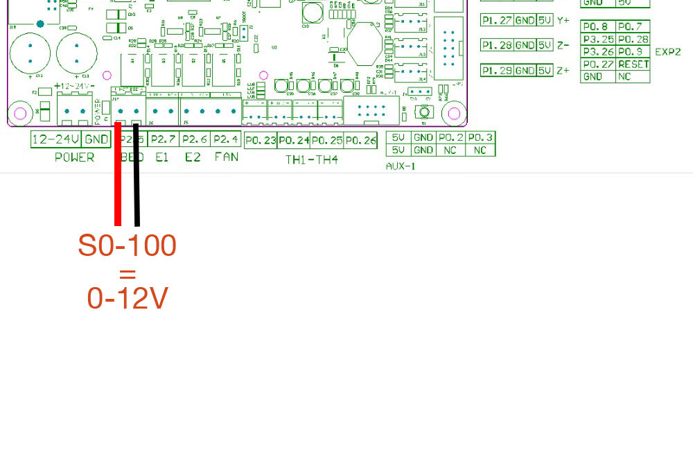

I need help again with this, cant get it work.
I figured out:
  • Between ± on J14 itself have 0-12V with S0-S100 (direction correct)
  • With +J14 and -J14 hooked up to 5V +J4 of course, i got 5-12V with S0-S100 (direction correct)
  • But with -J14 and -MainPower i get 10-0V with S0-S100 (wrong direction)
  • of course, with -J14 hooked up to +J4 5V and -MainPower i get 5-0V with S0-S100 (wrong direction)
– I need 0-5V with S0-S100
Sorry but that is a bit confusing for me.
J14?
Can you sketch the circuit (wiring) for each of these and identify the voltages?
Yes, i’ll make a fresh sketch.
And sorry, i mean J17 of course, not J14.
Measuring direct on J17 i get 0-12V with S0-100
Measuring between -Power an -J17 i get 10-0V with S0-100 (wrong direction)
Measuring on J17 with 5V from J4 i get 5-12V with S0-100
Measuring between -Power and -J17 with +5V from J4 i get 6-0V with S0-100 (wrong direction)
That is the wiring i understand from your sketch. So i get 6-0V (wrong direction)
Ground on the Driver Board are the same at the connectors, thats not extra wired by me.
I hope now it’s understandable what i mean and whats the problem :slight_smile:
@ManuelW
Diagram #1: measures between 12V and the PWM signal on the MOSFETS open drain. Not a relevant measure or approach especially if -Bed is not pulled up to 5V.
Diagram #2: measures between the ground and the open drain on the MOSFET. If the -BED was pulled up it should read 0-5 V. If not the MOSFET is floating and the reading is not relevant and undetermined.
Diagram #3:This is the correct circuit and measurement. I do not know where 6V is coming from, it should be 5V? Is the connection at J4 5V?
As I understand it, the circuit at diagram # 3 works it is just the wrong polarity for the diode driver. If you cannot invert the signal that is asserted at -Bed from the configuration file then you will have to add an inverter outside of the board. You cannot invert the signal by only changing how the diode driver is wired to the control board.
Were you not able to find a way to invert the pwm signal in the configuration file?
If not we need to think about adding an inverter to the circuit.
