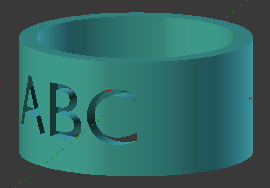

One of the design elements I would like to have is to use a second color of resin to draw/write on the wall of the cylinder. For example, where the letters are cut out in this image I’d like to fill with a second resin color.
