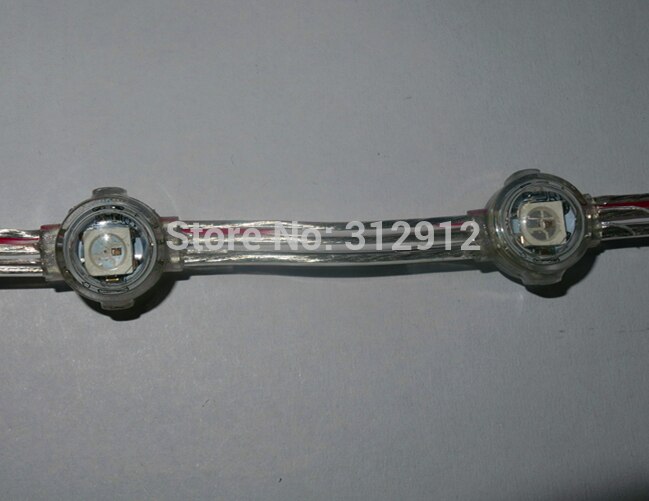

I’ve had success with this item. Super strong and flexible, none have broken after two years. Only downside (for some) is that 4cm spacing is the shortest available.

@Marty_Fox https://www.aliexpress.com/item/40mm-spacing-IP68-WS2812B-LED-pixel-string-addressable-rgb-full-color-DC5V-input-40pcs-a-string/32261145173.html is totally what I need, except that I currently have 1.7cm pitch and going to 4cm is 3x less density
If anyone makes this is 1.5 to 2cm pitch, I’m totally buying.

@Marc_MERLIN FWIW I checked with the Sam Wu store and they said they can go as low as 3cm.
