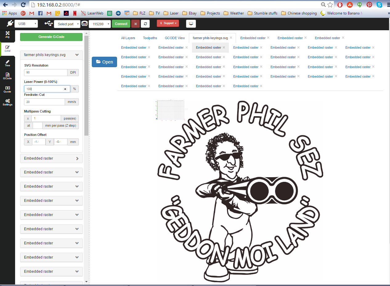

Howdy, i’m making the transition to laserweb from visicut and having trouble with importing SVG files, I make a lot of keyrings so i fit as many on a sheet as possible, laserweb imports them separately and at the wrong dpi, is there a better way to do it than manually resizing and placing each one?
they are tiled in inkscape, laserweb seems to then take the svg apart, this is the svg i am saving…
https://drive.google.com/open?id=0Bz4MXA1LvDdFaVJDX3M3eEEwb28
