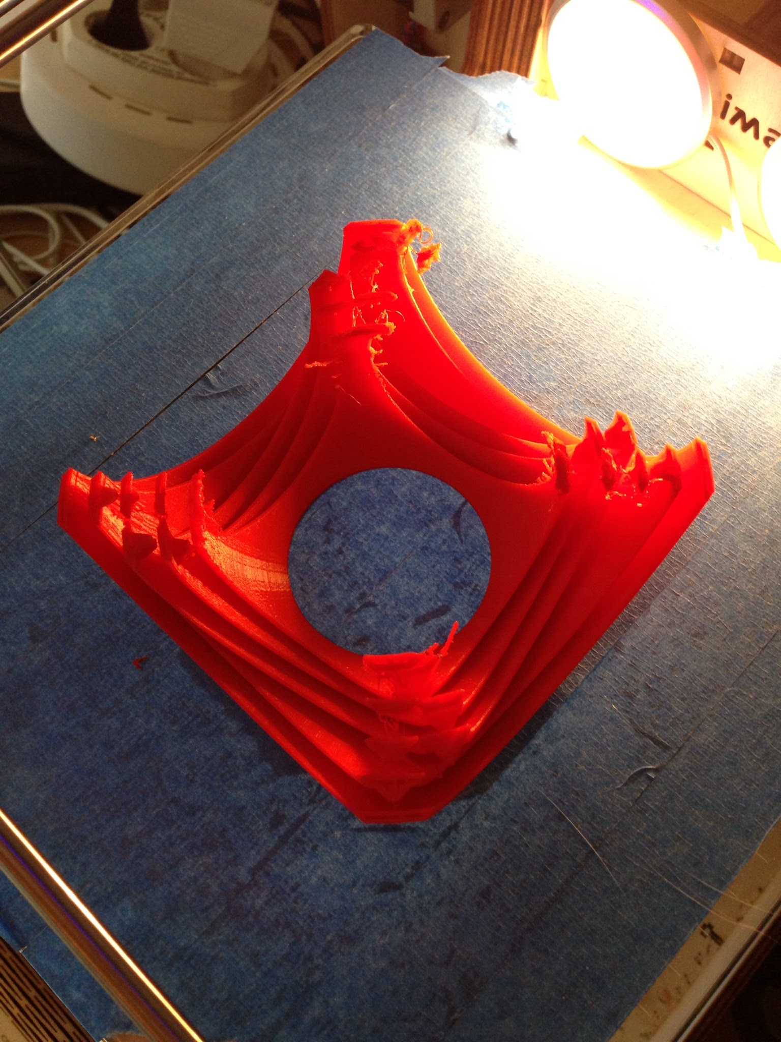

Hrmmm. 33h (at least) print failed after 17.5 hours. Two of the inner rings came loose. Should have printed with a brim.

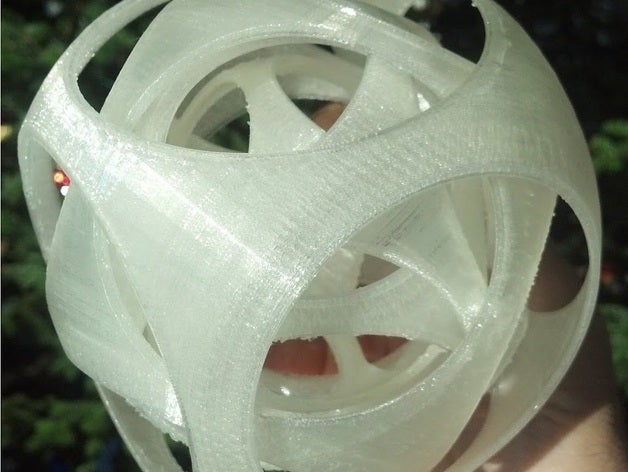

Did anyone succeed in printing this object (with FDM) ? (there are several editions)
I thought I would try again with a raft or brim.
What part is this?
What kind of plastic and what are you printing on (hot kapton, blue tape, abs juice, hairspray, futura)?
I printed in PLA and only blue tape. Good adhesion earlier and it held for 17h
@Peter_Parnes Did you try sanding the blue tape to rough it up? Hairspray (Aqua Net) may help also. I’ve heard people say a PVA glue stick can help too, but never tried it. 70C hot glass (no tape) works good if clean of fingerprints for me.
I might have been a bit sloppy. Will try again with brand new blue tape and no fingerprints. Sanding as well perhaps.
Doing another attempt now. Follow it live via a crappy camera: http://bambuser.com/v/3778009
Here is the more sucseafull second attempt: https://plus.google.com/104199731463622588564/posts/MPZrmCfv2U2
