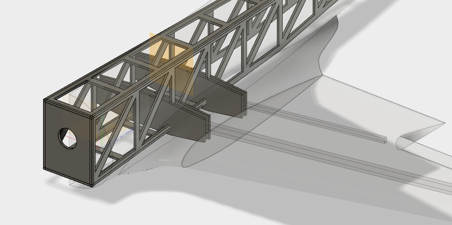

A sketch of how we’re planning on transferring the wing spar loads to the fuselage frame. What do you think? Can these plates be 3D printed? Maybe we need a composite of some sort (thinking plywood).
Cool! 6mm plywood is what I have now. But I’m up for trying to print them. How do we get those flat pieces in the fuselage?

I’ll provide details on how those will fit together. Likely some kind of slotting. These are just sketches :), I’ll flesh out the details after I get the big stuff resolved.
I understand what you were asking now: " How do we get those flat pieces in the fuselage?"
Because the fuse is sectional, you can add sections to the frame one by one, and assemble the frame on a per section basis. This way previous sections can easily slide past.
How big do the dimensions of 6mm plywood get?
My large laser cutters are 4’x3’ so diagonals can be longer. That’s the footprint though. I can manually feed larger sheets with careful planning. The sheets are 5’ squares. We can bolt or glue multiple pieces together of course
