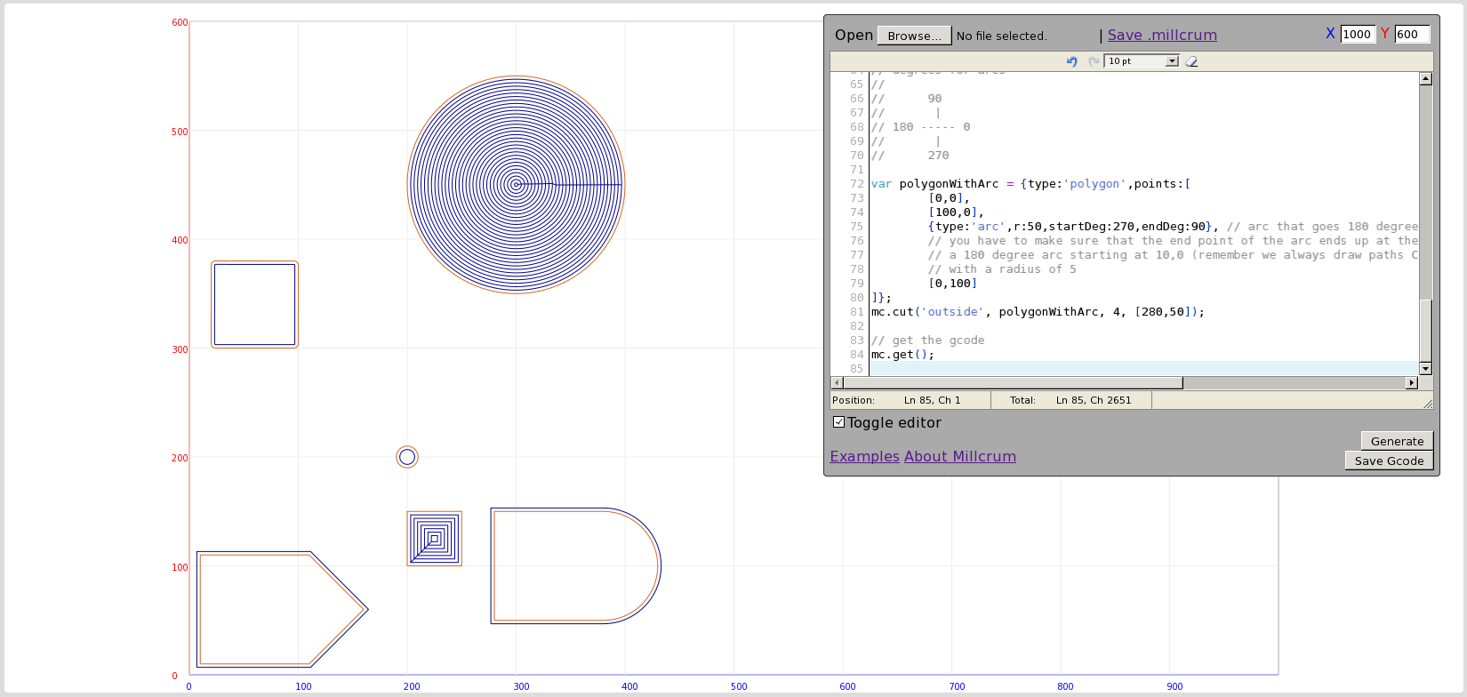

This works like OpenSCAD except for 2.5D Milling operations.

@Kyle_Kerr it is not a CAM package. The paths, tool definitions and cut operations are all defined at the input level and the output is gcode.
You can create a design, share it and the next guy only has to change 1 variable to use it on his machine. Hence the parametric part.
CAD and CAM are both 1 step and defined as a programming language. Read the About link on http://millcrum.com
It saves me a lot of time from design to cut and I can for example change the hole size for all or any number of screw holes on a part by simply changing a variable which defines said screw hole size.
