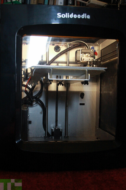

I see nowhere where the hardware was as likely to blame as the software, and the user/author. Solidoodles aren’t bad, but take a lot of fiddling (IMHO) to get tot the point that a well built kit / rep rap start at initially.
anyone else have similar or differing experience?

I got a chance to operate a solidoodle 4. I have no issues with the software since I’m coming from a reprap background. My only gripe with the sd4 is the backlash in the Y direction. I’m sort of jealous that the author was able to get perfect circles while I’m stuck here getting ovals. I’ve spent a couple hours trying to get rid of the y backlash. Tensioned the y belt numerous times, performed this “true circle” countless times, tried compensating the backlash through firmware and added a pillow block to stop the rotating m6 smooth rod from deflectjng. Maybe I got a bad apple but it’s driving me nuts. If this wasn’t an issue, the sd4 would’ve been a decent starter machine.

idk if it is the same issue @Chris_Lau , but when I used a SD2, making sure the driven y axis shaft stayed centered in the x direction for its entire travel range. I think we did this by loosening the drive pulleys and running the carriage back and forth, then tightening them at the “true” alignment they took.

Are you kidding? The solidoodle machines are the most shoddily-designed printers I’ve ever had the misfortune to work on. Even the poorly-built Printrbot Jr. I worked on for someone had more redeeming qualities.
@Whosa_whatsis What would you consider a better choice for the same $1000?
@Anthony_White I’ve done this a couple times but can’t seem to get it truly align. I guess I’ll try again but I’m ready to design a new gantry if I have to.
Yeah the solidoodle mechanics leave a lot to be desired. First thing I did way back when was replace the extruder, then eventually the entire z-axis. Still never printed that well. Went through a ton of their crap hotends as well.
